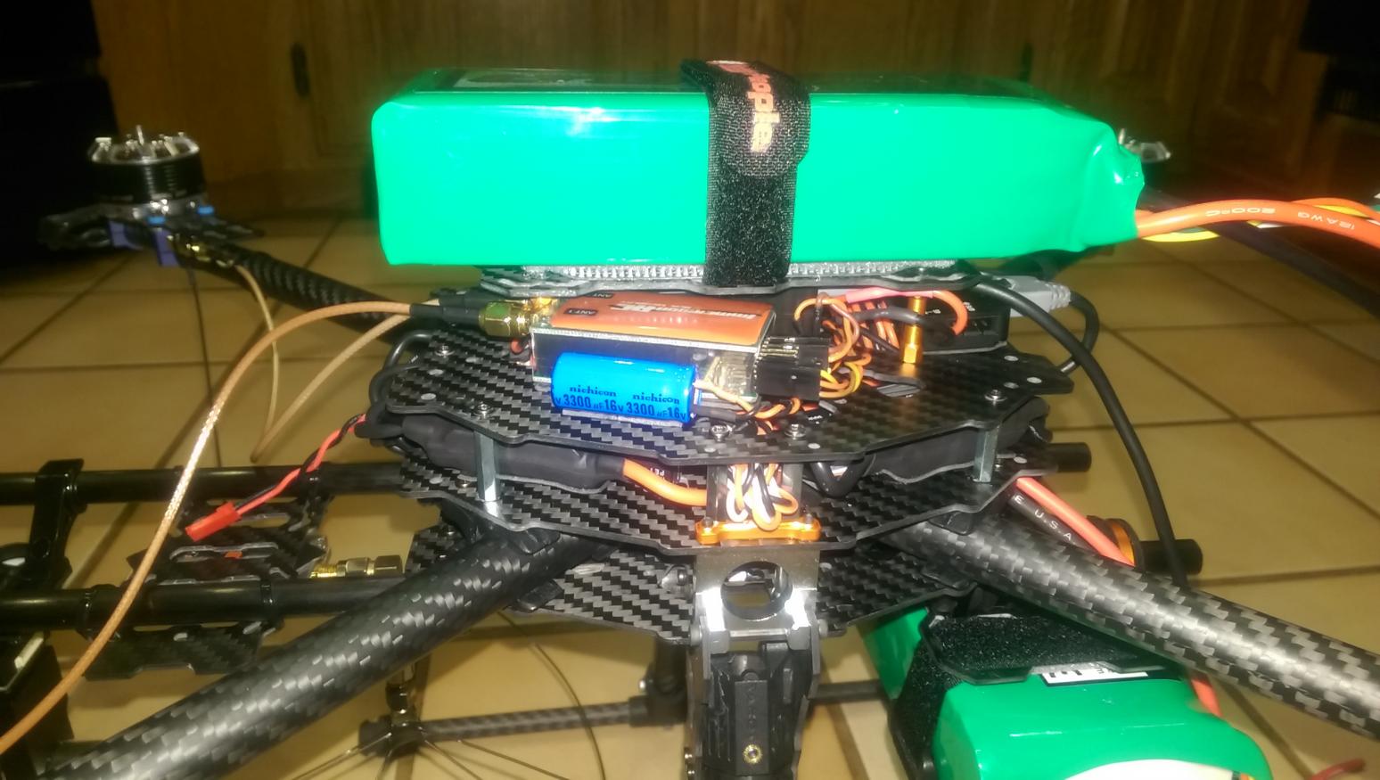

SJBrit
That's the power layer done. ESCs installed (not hooked up yet), BEC for the FPV Tx, current sensor for the Tiny Telemetry and pigtails for battery-in, PMU, gimbal GCU and voltage alarm. I have another center plate coming which will layer over this and then I can mount all the electronics up top. Starting to take shape!

SJBrit
I finally got the extra center plate yesterday so I've been able to finish the build. Here it is almost ready to fly - just got to wire the battery connectors on and hook up the gimbal and Video Tx. I'm really happy with how it went together with the ESCs and power distribution on one layer, then adding another layer on top for all the rest of the electronics. I have no idea how I'd have stuffed everything in there if I hadn't doing it this way - ESCs hanging underneath I suppose. Anyway, a little more soldering in the morning then the moment of truth....

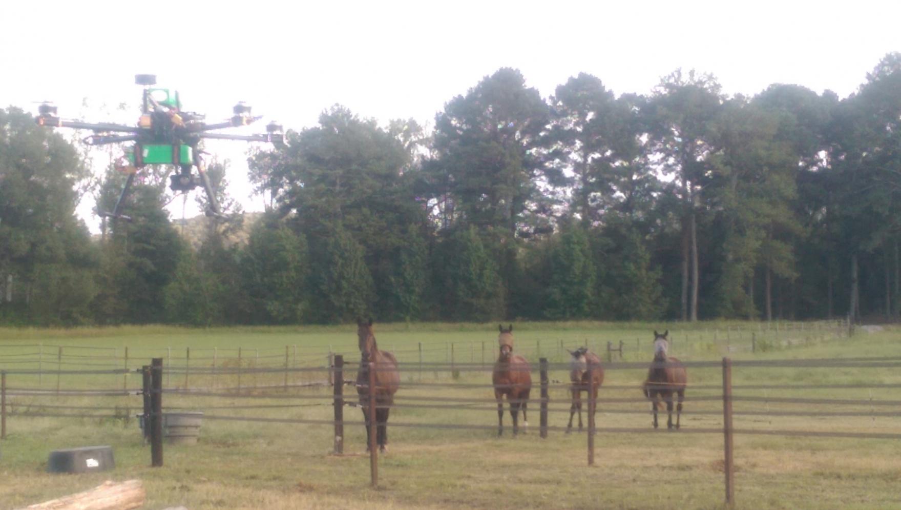

SJBrit
It flies!! No hiccups at all - just started those lovely sounding motors up and popped it up off the ground. Hover looked really nice and stable but I do have to get the gains dialed in a bit better tomorrow and the battery thresholds are all wrong. But woohoo! My first build and so far so good :) Will post some performance numbers once I have it dialed in a bit. Flying on the 14" props and 6S batteries right now - will hopefully have time to try the 17"/4S combo tomorrow too.
SJBrit
Super happy - test of the 14" prop, 6S configuration has me at 22mins hover time at 80% battery capacity. Right on target! Now to test the 17"/4S config.

SJBrit
Well, alright! That's 31 mins with the 17: props and 4S batteries - and SUPER quite: it's worth having that configuration just to hear it :)
That's the hover tests all done with - now to dial-in the gains properly - they are pretty close now. I'll also do some speed tests mainly to find out the limitations of these larger props.
Anyone know how I can edit my original post with the flight data? I don't see an edit button on that one anymore.
