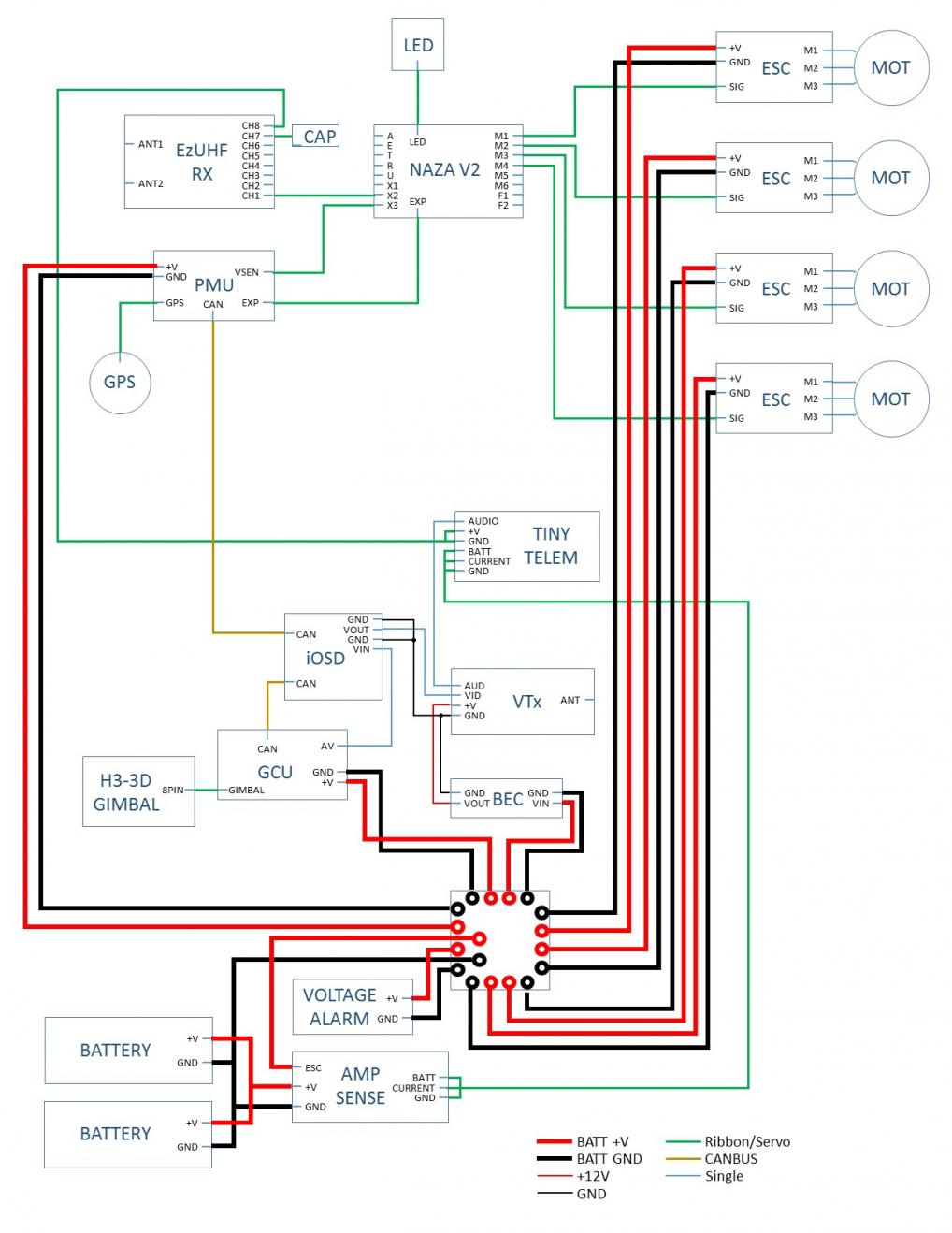

SJBrit
Wow, that came out small - sorry. Let me try that again:
AzViper
You stumped me with your power layout. You got more on there than I will be using I believe.
SJBrit
That's fine - I have stuff that's not strictly necessary. I just like that power distro board since it gives plenty of outputs for various devices.

SJBrit
I plan to run at 6s of which 22.2 volts. In your drawing your running two batteries in parallel. The NAZA will operate between 7.4v through 26.0 volt. Power from your distribution board feeds the PMU of which I assume feeds the NAZA V2 and RX 5 volts.will need to step the volts down from 22.2 volts to 5 volts for the TX and 12 volts for the gimbal and possibly 5 volts for the GoPro.
In my case if the above is true then this will work for me as well to feed power to the NAZA and receiver. The Immersion TX I am using needs 5 volts and the FeiyuTech G3 3-Axis Gimbal operates between 9v-17v and has an integrated controller/drivers/motors.
I will need to step the volts down from 22.2 volts to 5 volts for the TX and 12 volts for the gimbal and possibly 5 volts for the GoPro .
Yes, you can put 6S straight into the PMU which will run the Naza and the Rx. I wouldn't worry about 5V for the GoPro - it has a great battery which will be onboard anyway so you may as well not pull the few electrons it takes to run it from your flight pack. My VTx runs at 12V so the BEC I have is dedicated to that. It could easily run your gimbal too. If you need 5V elsewhere then you can pull from a spare channel on the Rx like I have done to power the Tiny Telemetry. Be careful of current draw and current spikes though. I am running a big capacitor on one of my spare Rx channels to protect it from losing lock during a brown-out caused by other components.
