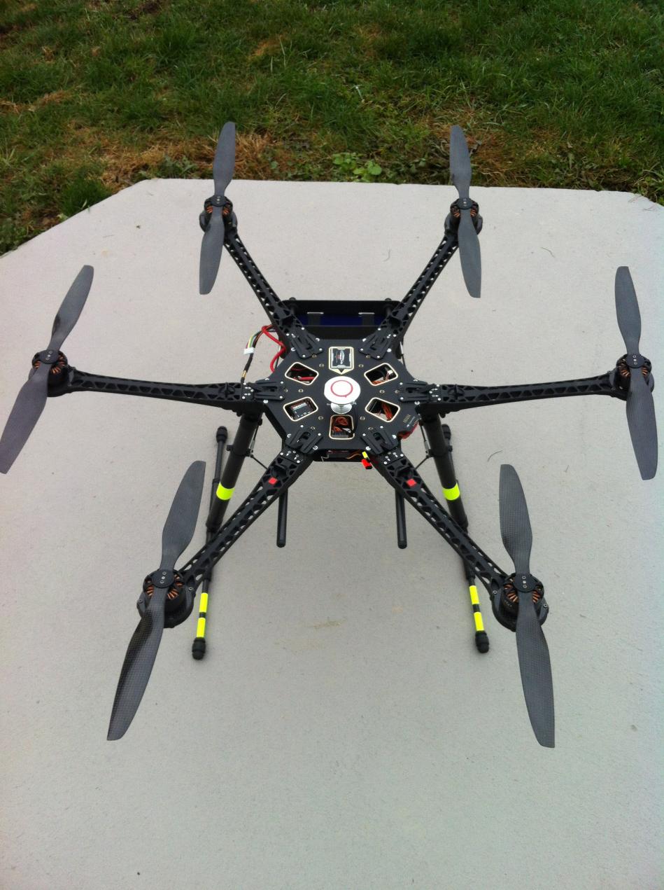

I have one on a f550 that wobbles.... using S-Bus futaba 8fg, no FPV, no gimbal.. first fail-safe flight on 5.12 activated Fail-Safe by turning the TX off.. WKM also took down a S800 the same way but on 5.08. Decided to "R & D" on a cheaper frame. Would have thought DJI would have a more manageable evaluation process or more interactive evaluation process with selective owners in different region before posting available for all to download. I am new to the hobby, so I was not expecting to dish out double the cost and still have to do my own R&D. Maybe the Arducopters is looking just as fun..:) and just as easy as the DJI products. This same f550 and setup was upgrade that morning.. had been hovering around the yard and house all morning.. then i headed to the park for the fail-safe test. Here is the results.
you can see the wobble throughout the video.. but very apparent during decending (2:59 on) from fail-safe.
Then this next video is after the WKM landed, I wanted to just hover in GPS/ATTI till the battery low activated the landing... but it landed much sooner..:(

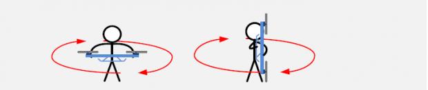

You are calibrating your bird incorrectly. You need to spin the bird on it's own axis... you cannot spin it with you as the center of the axis. Your IMU will not work correctly this way!! Not sure your crash is due to incorrect IMU calibration though.

View attachment 5253 guess I was not technical enough to read this diagram.. and not able to interpret the instructions well.. 2 out of 2.. I am hopeless.
When I get both WKM back.. one for LED issues, the other is the one in the video for the reseller to check it out.. perhaps I will try it the right way.
Thanks for the corrections....

ps.. to my efforts..:) it does look like the red directional line indicators do go behind that stick figure...:) in both image.

I have always calibrated the compass the same way as you? mainly because my machine is 1000mm diameter and 600mm tall and weighs 5kg without a camera... So turning it on its own axis is very awkward. But it has never caused me any problems? and in failsafe will land within two foot of where the home points is.. When calibrating other electronic compasses such as the ones you get on a mobile phone or some other flight controllers they dont require to be turned on their axis? only to have been moved in any direction so they can detect the magnetic field from every angle and decide where north is. This should only change when you move maybe 5 miles or more away from where you calibrated last, although it wont make a huge difference, at 5 miles away it is recommended to re-calibrate

Humm... Maybe with WKM it does not matter? I came from MK multi rotors and MK must be calibrated on its own axis. Was also told by my WKM dealer when I purchased it that to make sure I calibrate rotating the bird's axis and not hold and spin around.
On the H axis... I agree.. It is not that critical as either holding and spinning or spinning on its own axis as its within a few feet. But on the V axis... It is completely different holding the bird vertically and spinning or spinning the bird vertically on its own axis.
From MK... We were told to move away from all magnetic fields... Remove all metal objects including your watch away from the bird when calibrating to get the best calibration possible.
Anyway... Love to take a poll to see how everyone is calibrating on WKM.

Another question is if during vertical part of calibration copter should be kept nose up, side up or it doesn't matter.
apeman88
Avatar... I can't explain it... not an engineer. But here's how MK's are calibrated and was told WKM should follow the same procedure? Would love a confirmation on this.

Yes it would be good to know their logic behind it? especially doing it on top of a metal framed table inside a building?
