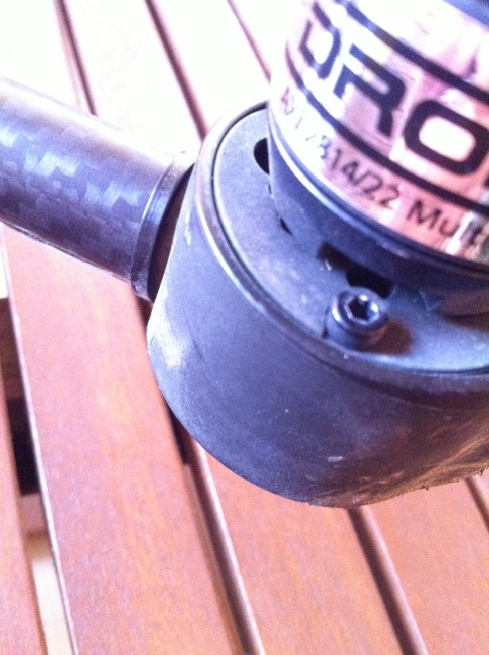

Hi everyone, I switched from 5.6 to 5.12 of OKTO frame droidworx with the 5.6 I had problems only in-flight engine mounts broken and half fell: ( I conducted the tests at the bench, tying the OKTO and I saw what happened with the engine support cross-section undergoes abrupt angles in flight causing an uncontrolled rotation of the half. I upgraded to 5.12 and not wanting to use sbus rx with futaba 6208 sb to return to the 5.6 firmware after reading some of the problems they are having all and frankly I do not understand the cause .. how can I downgrade to 5.6?
I saw the link a few pages back but get more than 5.2
thanks
As far as I can remeber its 1.23 for 5.06 respectively 5.08
But I am not absolutely shure.
I am not at home tomorrow. If you do not find the information, please let me know. I will then check my flight-notebook. There I do have the versions installed...
