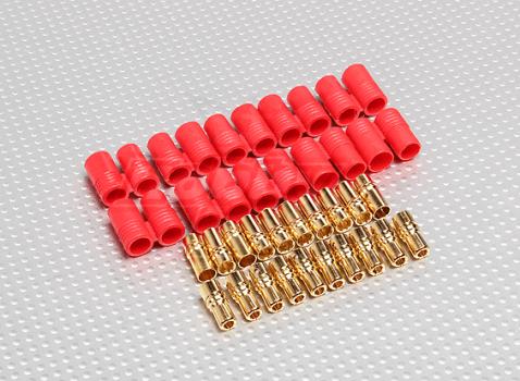

After a lot of tryal and error, I use EC5 plugs for fat cables. There are 2 different types on the market....some got "banana-style" and some got "bullet-style" males. You want the bullet style:
http://www.ebay.com/itm/1-Pair-EC5-Bullet-Connectors-Plugs-Male-Female-Losi-/280741842660 ...this link is just to show how they look like....you get them a lot cheaper if you Google around.
If the wire is still too thick, just tin the end with solder, let it cool and use a Dremel tool to make the diameter to your needs.....works perfect.
One last trick: If you stick the connector in their plastic housing, wait a little bit after soldering to let it cool down just a bit, but insert them as long as it is still reasonable hot.....makes inserting easyer but will still hold them in place.

Think I'll go along the same lines as you guys for my 4S stuff. EC5's or PRC6's
