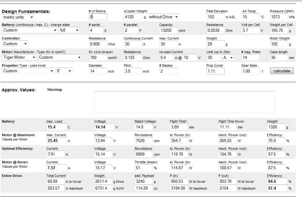

Attached is my Ecalc, would somebody double check it for me to make sure im not being an idiot

Blacksails
I have checked for the props and can fit APC 13x4.7, giving a higher disc loading, which i hear the WKM likes......if i decide on the DJI that is.
Has anybody been succesful with heavy platform stability and the DJI??
Cheers
Alex
Sebas600
The ecalc says 14" and so does your text. can the props fit the frame? make shure this is possible. large props give more lift but can be less stable in flight and can't compensate very quick in higher winds is the idea.

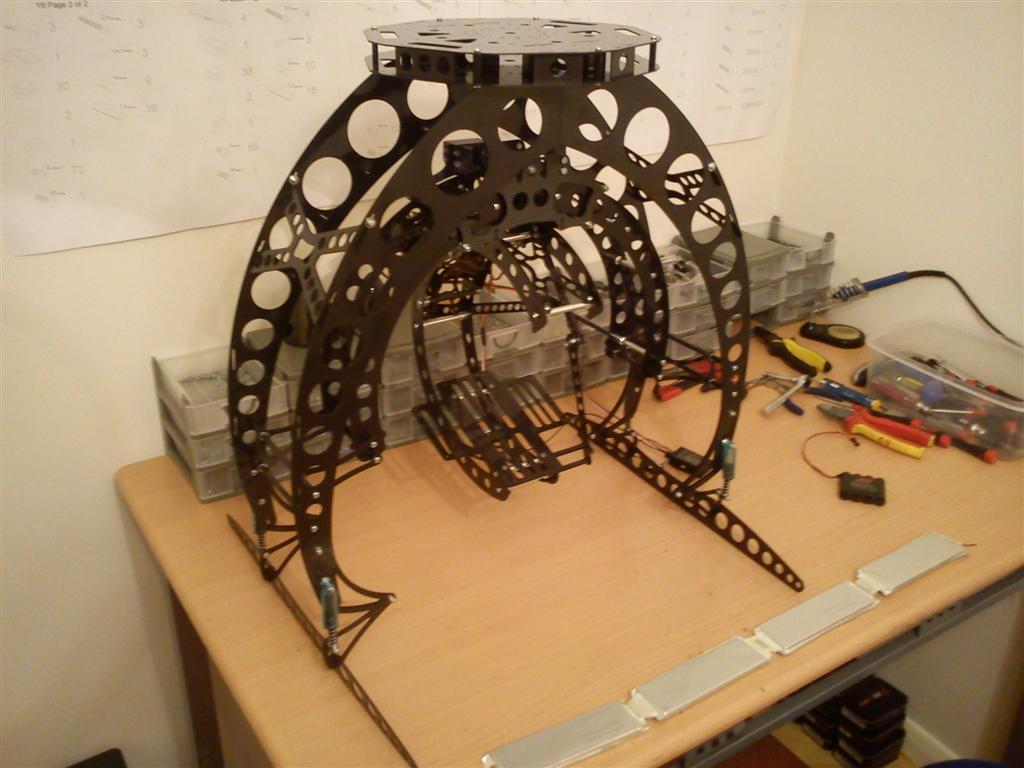

CarbonCore
Hello,
The New Octo weighs in at 1080g, with the standard short landing gear and protective top dome. (Arms can be folded).
The New MegaRadius weighs 1500g, with Landing legs, bracing supports, shock abosorbers and extra large skids.
It has also been found that the Octo 1000 can lift the Mega and a 5D on 2x 4S LiPo packs.
There is also a 3-Axis Mega in production, to be flown shortly.
Here is the current 2-Axis Mega with a few Octo frame plates:

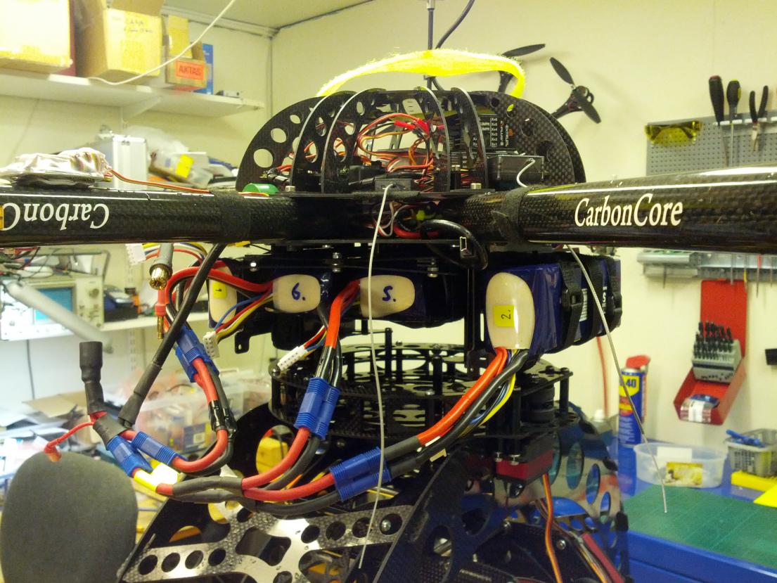

snurre
Hi guys,
I have been playing around with my CarbonCore octa 1000 and an icecream box filled with sand.
Yes - it is a payload test. The camera mount is a Mega radius 3 axis.
Check it out at youtube:
Cheers / Tomas
snurre
Endurance test CarbonCore octa1000 + Mega Radius
Battery: Turnigy Nanotech 35C, 4S 6000mAh*4 = 24000 mAh
By mounting an extra pair of batteries on the side wall plates I can put together 24Ah.
AUW, including 800gr camera, was 8.5kg
I had it GPS hovering at 40m height, slightly turbulent conditions. At end of flight ETS telemetry indicated 21500mAh used.
Then WKM primary warning had then been on for approx. a minute. I did not wait for secondary voltage alert, but it must have been imminent.
Flight time: 15 minutes :02.47-tranquillity:
/ Tomas
