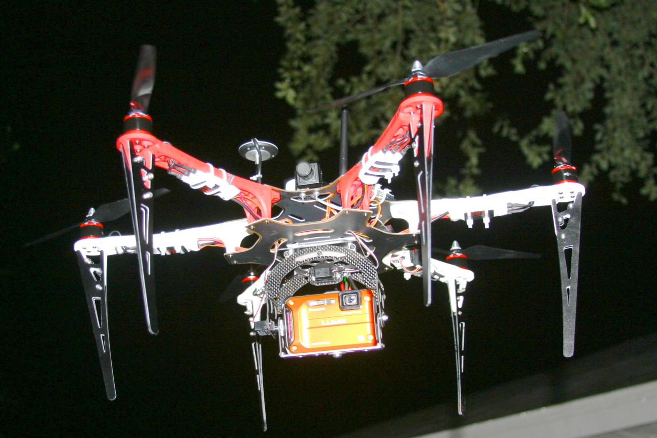

I have fitted the Crane II, here is what I did
1) you need shorter connector rods
2) you prob don't want to drill into bottom board because it may short out the bottom board
When I get home tonight I can tell you where I got the connector rods
Instead of drilling holes I used a thin piece of fiberglass board and 3M tape to secure it to the bottom
Here is what it looks like with the Crane II

Forgot I had this pic, it shows pretty clear on how its attached

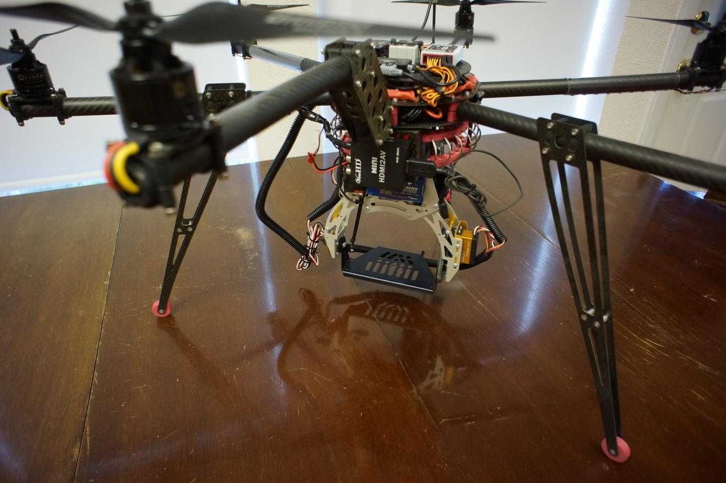

I got these to make the Crane 2 fit with the legs I also got from them
15mm Aluminum Hexagon M3 (10pcs)
FAS-15 1 US$4.25 US$4.25
http://www.gothelirc.com/shopdisplayproducts.asp?Search=Yes&sppp=20
Their support email will let you know if it works with the Crane 3
Thanks for this Gencode, appreciate it. I just need to see if they either ship to the UK or if I can find something similar online.
Could I ask a question, how did you fix the rods to the F550 frame?
I don't want to drill any holes in the plates for obvious reasons...
