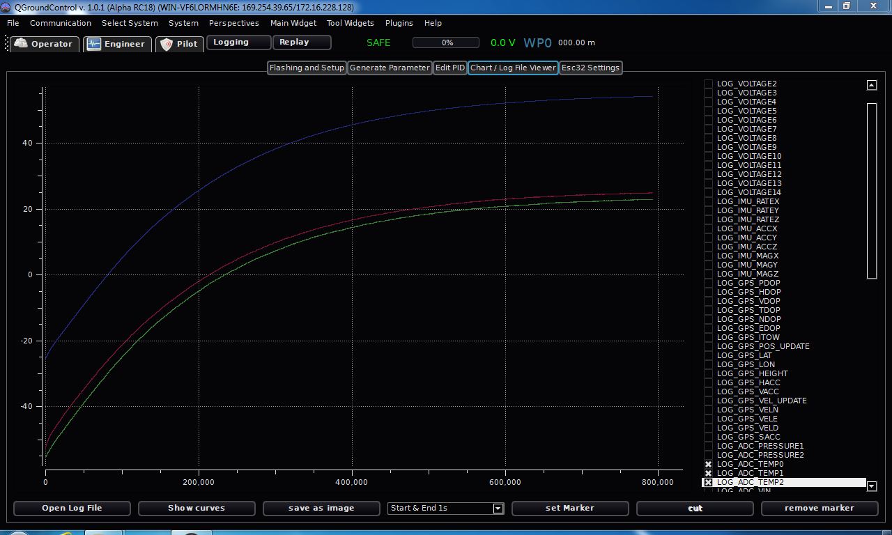

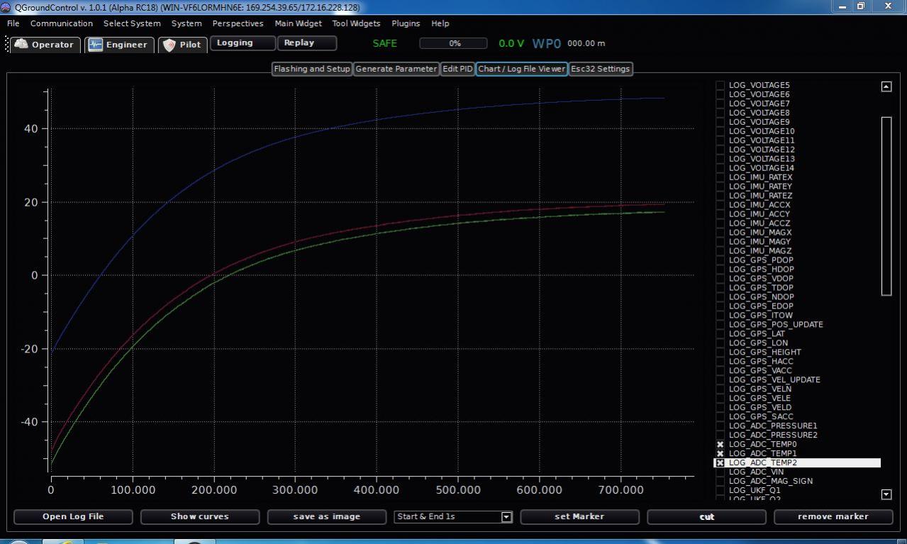

Okay guys. I am struggling a little :( Have 9 logs attempts behind me and i just can't get it perfect.
Last attempt now outside in this box away from anything !

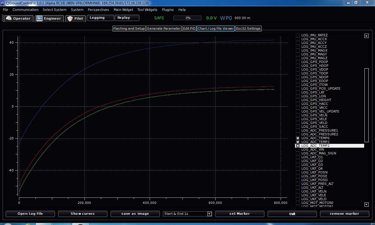

Temps are really strange. Outside temps are 10 C, board and static bag are warm after logging. Are these Y Axis numbers actually Celsius ?
Inside also i can't get more than 22 C even if I let the log gin go on for 80 mins. Or is it the blue line that states the right temps ?

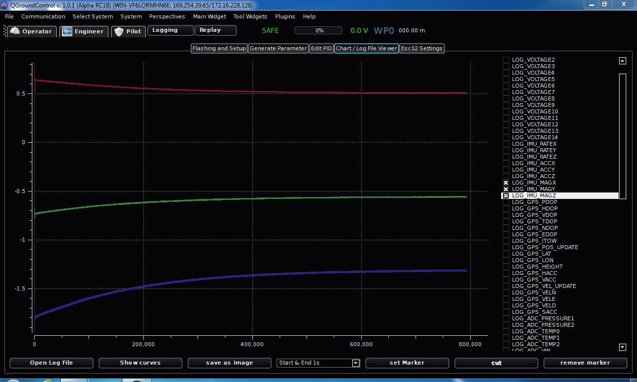

Now Mag i just can't get it right. These are the outside results:
These are the best results i got inside in the fireplace, in this run the ACC logs were crap. But in the following attempts i could not replicate the good MAG results ?
Any inputs were I could still be messing up ?

Okay i am going to stick to these logs for the static just can't get the mags better. Also compared to other MAG logs from other people and figured that my Y axis has a smaller range thus my MAG curves look more unstable but i guess its not the case. I hope they are fine this way ?
Boris
ACC DOWN,UP,HOR
MAG DOWN,UP,HOR
RATE DOWN,UP,HOR
TEMPS DOWN,UP,HOR

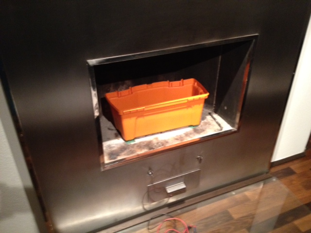

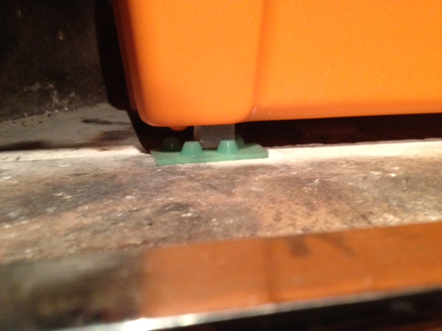

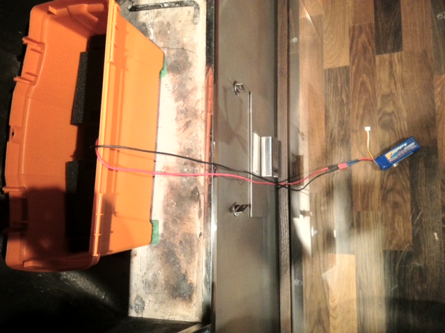

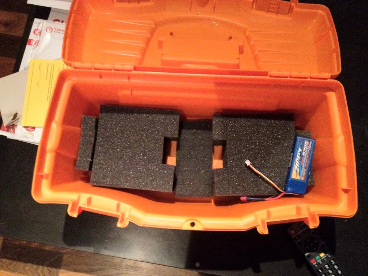

I eventually preferred to use solid walls or the fireplace and used the following, also knowing there are not wires close by in the walls etc. Switch actually every electronically device on the house :)
Foam in a case.
and than i used silicon cubes and sheets to filter out some more. I think my ACC and Gyro logs were good the problem for me is more in the temps and the MAGs which has a different source than vibrations.
I used an extended lipo cable. So when i put on or take off the lips I don't move the board. Than you don't have to cut the beginning and end of the logs if you have any glitches.
These standard kitchen plastic cases are good, but i didn't get around using a plastic bag additionally. Using the plastic bag results in less air around the board thus less condensation can happen. Before I closed the bag airtight in the freezer i tried to get most air out of the bag. Additionally i also used this Gel Silicia or whatever its called to suck up any moisture.
Eventually I cut a hole in the bag and let the power cable go through. Than air tighten it again with silicon. Having the cable come out of the opening in the bag doesn't let you get the bag air tight.
In you case with the train, hmmm its probably not going to be a easy task ;(. Try it out and dampen with whatever you have. If it doesn't work you have to look for a different spot
Boris

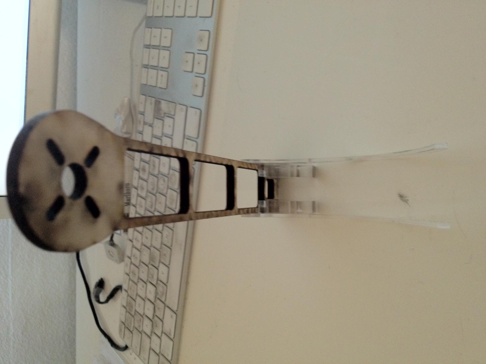

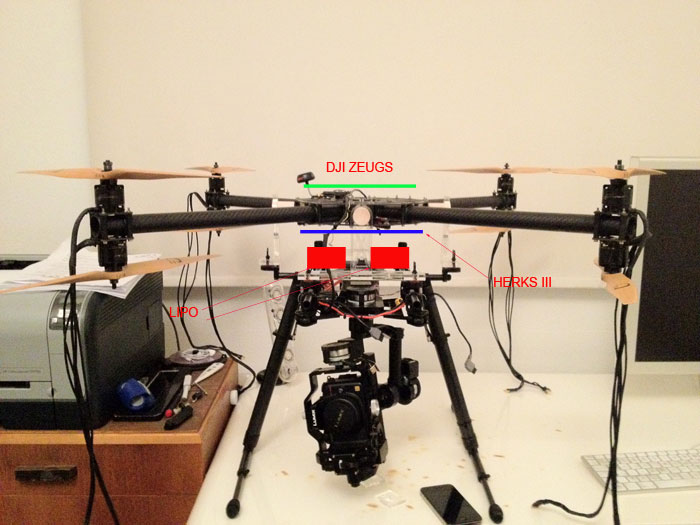

Hi Jess,
can't say yet was a little set back, had to send a board back because of some strange temps reading of the gyros and the mags didn't do what they should have. Than a new one was send to me which was great instead of waiting for a repair. Unluckily the shipment took 2.5 weeks this time from germany :(. But it arrived and this weekend I will carry one with the calibration etc.
In the meantime I setup a XBee to Xbee connection and than breaking out to a bluetooth module in order to get my Nexus 7 to show telementy, which i think it very cool.
Than another set back the guy who should have done the arms for me needed ages to send out the estimation what thing will cost. Eventually he wants around 150 Euro per arm and i told him he can forget about it.

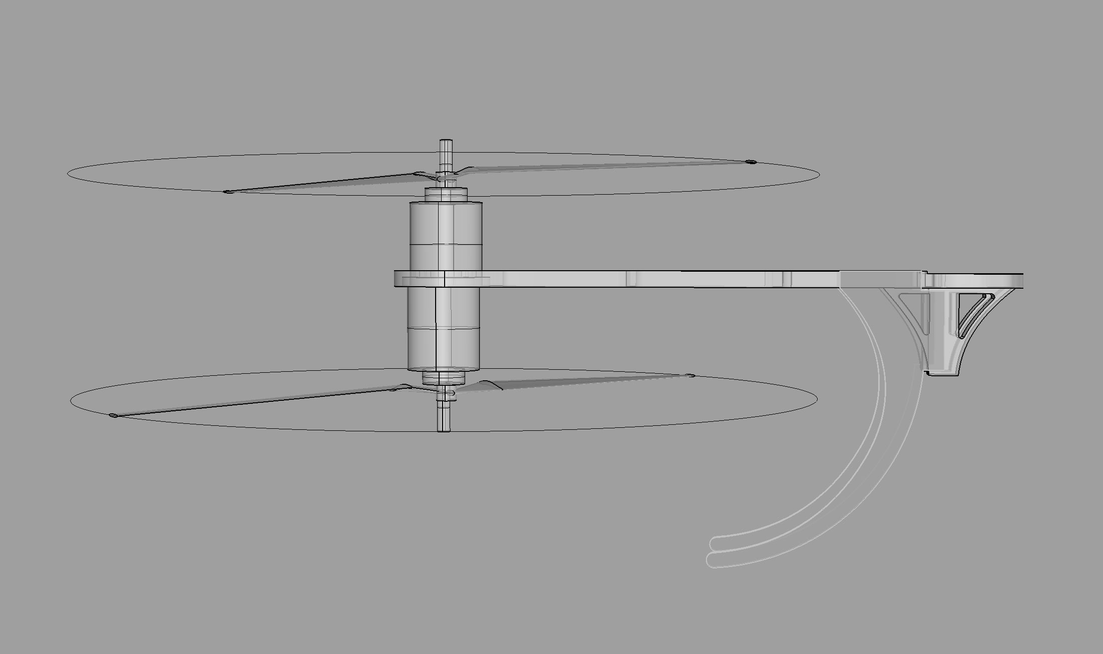

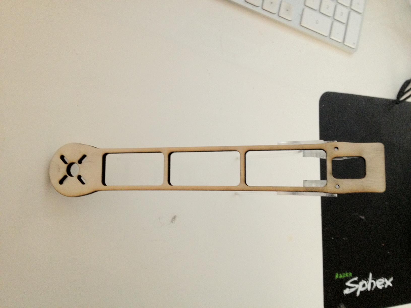

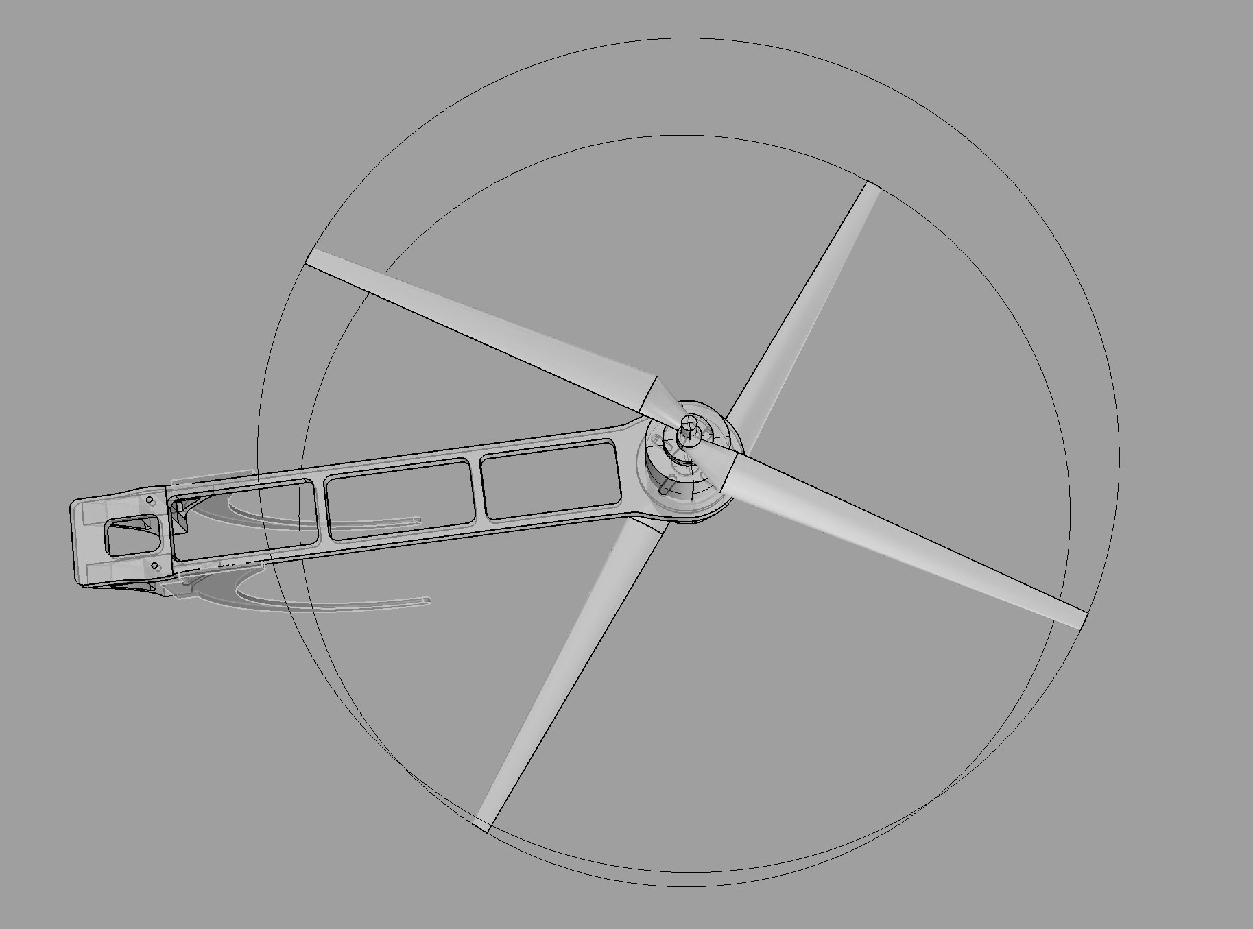

Instead I took things in my own hands and start to design and module the arms plus landing gear etc. Hope to get the final touches done on the weekend and send things of to another CNC guy.
View attachment 7651View attachment 7652View attachment 7653
(edit) should have never started to with the Rhino feel like i should do the whole copter now :)

Hi BorisS, very interesting project, this might be a dumb question, how are you going to attach two motors to each arm. I can not see a seperation between top and bottom mount to allow for screws (assuming you will use same size motors).
Regards - bruce
BorisS
Hi Bruce i am sitting at it at the moment. First wanted to do the Arms in a traditional way without the coax mount option. I am just creating two plates that will allow to mount the motors to them and then sandwich in the standard arm. Will post later if my beta Rhino OSX version doesnt let me through my desktop out of the window any time soon :)
