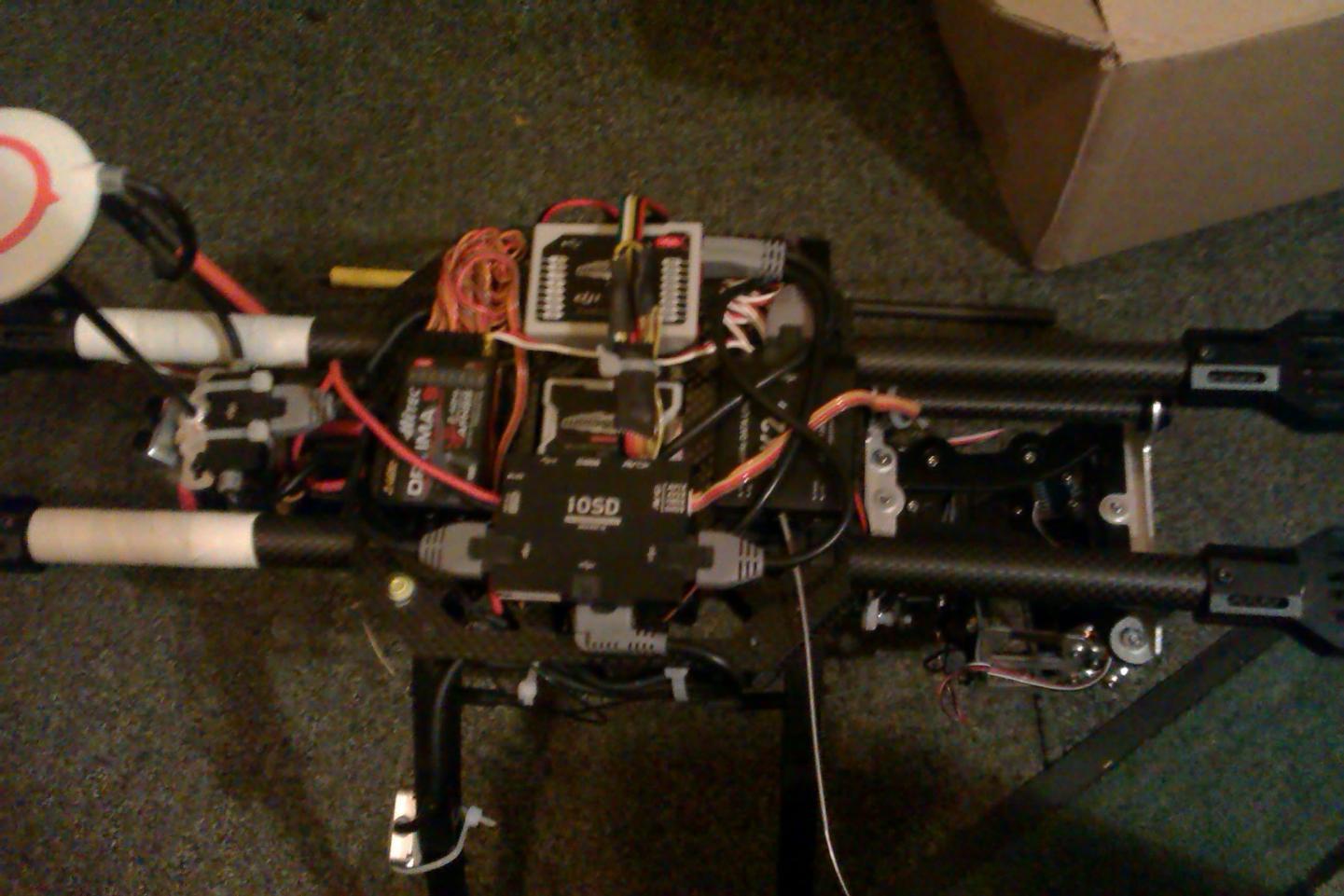

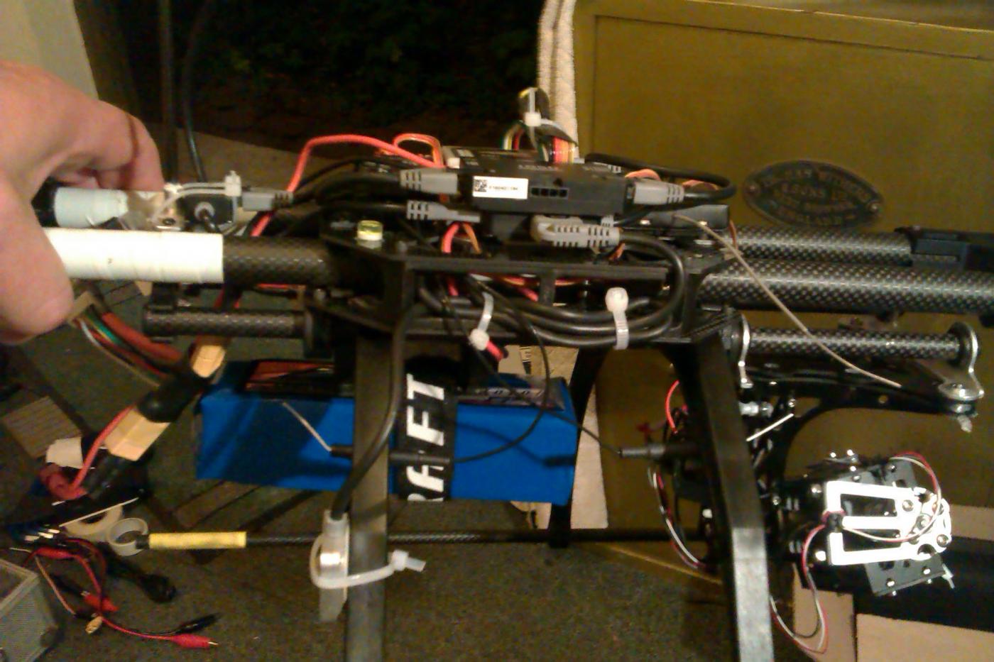

CrashMaster
I think you are right. But there was only a 30 degree pitch available, which is why I have loaded 61. I haven't tested it in flight but it looks smooth when played with in my shed.
View attachment 12363 View attachment 12364
