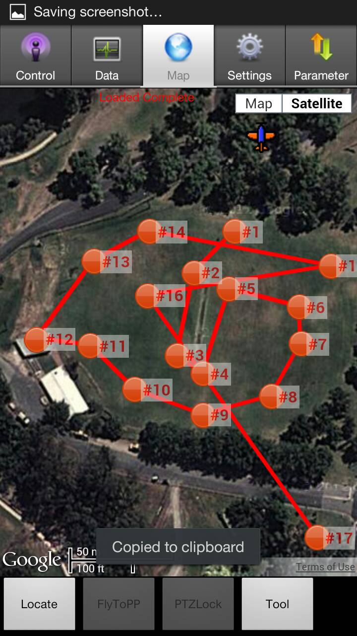

Nic, can you do me a favour. Using your Android tablet, have you saved way points, deleted them from the screen and then and tried to load them again? If you have not, please will you try and let me know whether you can do it.
Rob
nicwilke
Rob,
I can plot waypoints, then save and title it. Then remove them from map, and load the saved file.
I'm on phone, not tablet.

robone
Rob,
I am using a HTC Flyer tablet and a Samsung S3 phone and in both cases I can save the file but cannot load it. It force closes the app
If I take a file saved by the PC GCS and transfer it to the Tablet and then I can load it and it works. If I then save it and try and load it again, it does not work.It force closes the app
I did an exercise:
Using the PC GCS, I saved a waypoint file called “PC Saved waypoints” and it has a .skw extension so the name was PC Saved waypoints.skw and below is content of the file:
28.036907 -26.150017 20 0 1 0 1651
28.036963 -26.150066 20 0 90 0 1651
28.036919 -26.150099 20 0 90 0 1651
28.036873 -26.150051 20 0 90 0 1651
I then transferred it to the Android tablet and it loaded onto the tablet. This worked well, and there was no forced close.
I then saved it as “android resaved pc waypoints” and it now uses a .rw extension so the name is now android resaved pc waypoints .rw and below is the content of the file:
28,03691 -26,15002 20 0 1 0
28,03696 -26,15007 20 0 90 0
28,03692 -26,15010 20 0 90 0
28,03687 -26,15005 20 0 90 0
This would not reload onto the tablet and force closed the app.
If you have a look at the 2 files you will notice that the numbers 1651 are missing. I do not know what those number mean, but it is obvious that there is a problem with the way both the Android application saves files and leaves off those numbers.
Rob

robone
Rob,
Found the problem. For some unknown reason, South Africa decided to use the comma as a decimal delimiter many years ago. The ZeroUAV team spotted this and once I changed the Country on my Tablet to an English country that uses the decimal point as the delimiter, then problem solved. They will soon be updating the App to cater for this. Its amazing how such a small thing can cause so much hassle.
