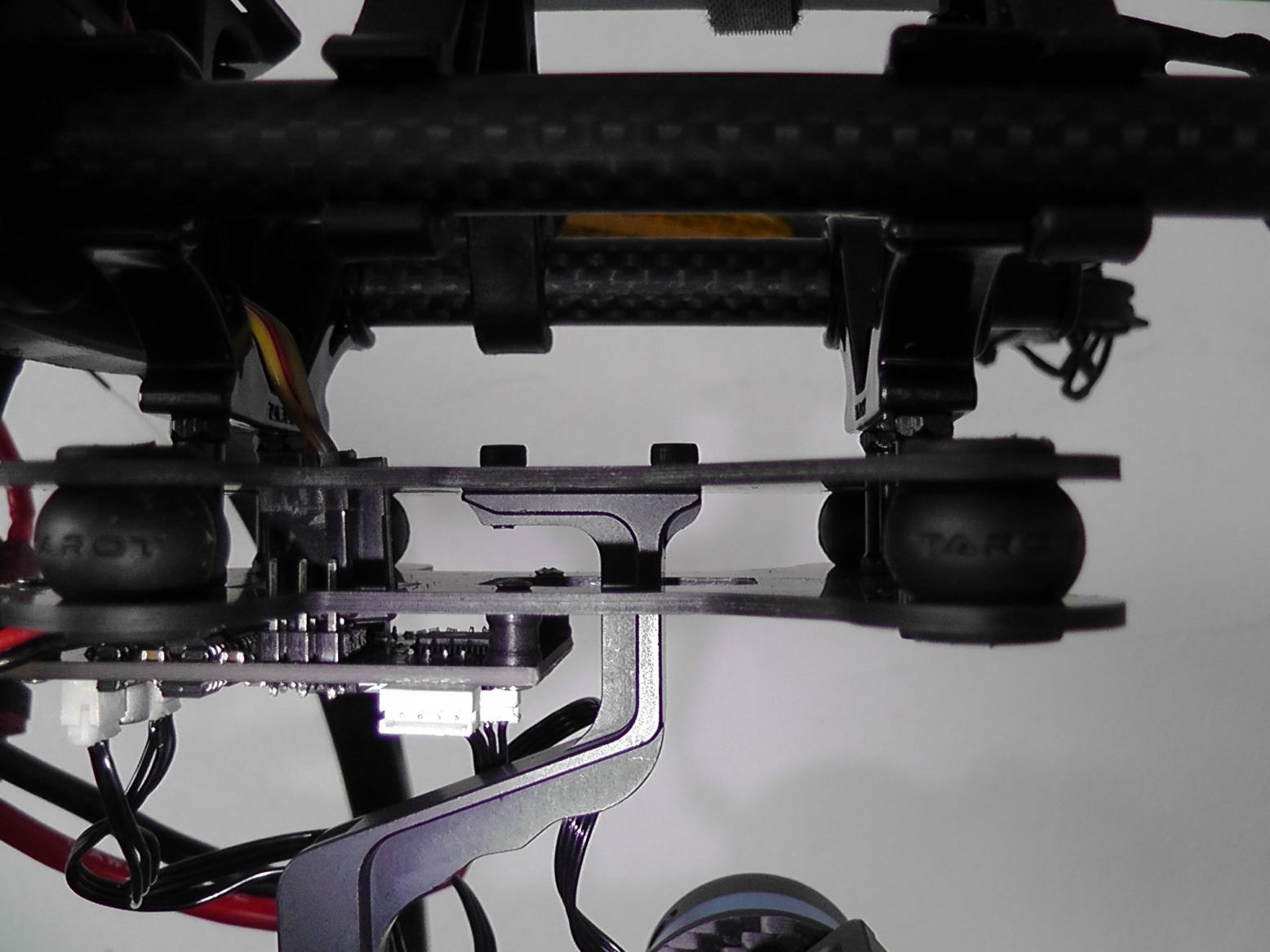

as you say when ever using the grommet type balls for vibration dampeners between two plates
a good safty tip is to use a couple of zip ties through the centers of at least two of them for the added safety factor
dont sinch the ties up tight leave them slack so they dont effect the dampening
should the grommet balls pop free from the plates then at least you still have the gimbal etc still tethered to the frame via the zip ties

Proper gimbals should be designed so that the weight is hanging from the top plate, therefore compressing the balls, not the bottom plate, where it is stretching them... That's where the balls perform best. This way, the camera can never detach from the mount.
check out the Tatot T-2D. It's done like this. View attachment 13989

Its quite amazing how many of the gimbals using these types of balls for vibration isolation have the design so completely wrong. Those balls are designed to be used under compression as you have shown with the Tarot version. Quite staggering that DJI engineers have got it so wrong.
check out the Tatot T-2D. It's done like this. View attachment 17650
