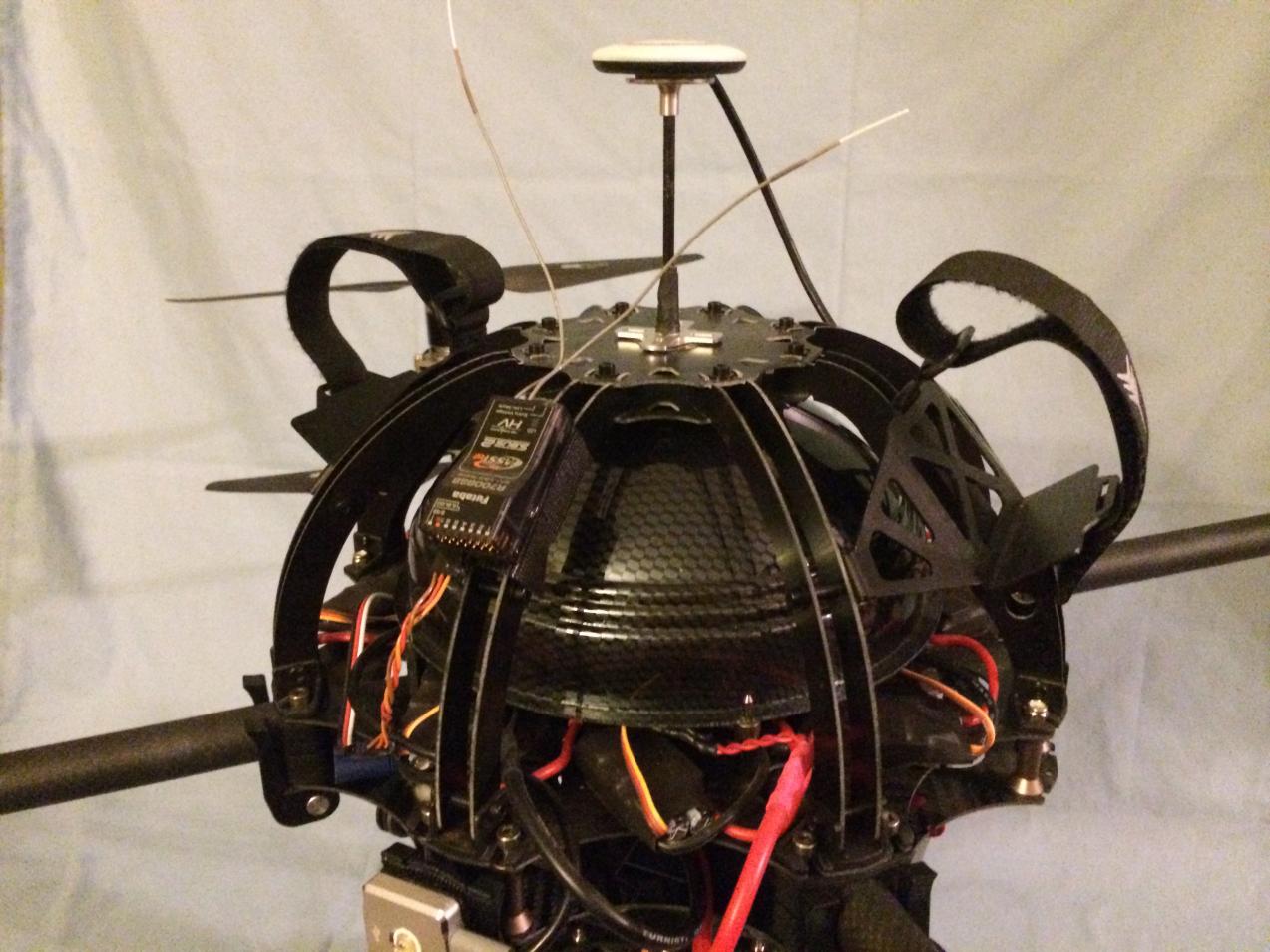

The Wraith has options yet to be explored. FPV is top of the list. Retractable landing gear, just for the fun of it. She will be mostly airframe, with limited sections protected with a 'shield' if you will. The overall look planned is that of a mechanical insect. The FPV camera for instance is set up to be the head. It is also why the camera gimbals assembly is more ornate than need be. I want to be able to look past the shielding and see the cool mechanisms beneath. I am also contemplating designing a miniature BB gun for it. It would be fun to shoot targets like cans, etc. I don't expect extreme efficiency, after all this is all about fun. But, everything that is going into her is designed to be as efficient as possible to make up for the toys.

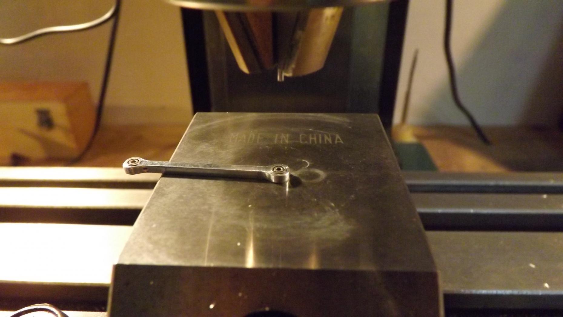

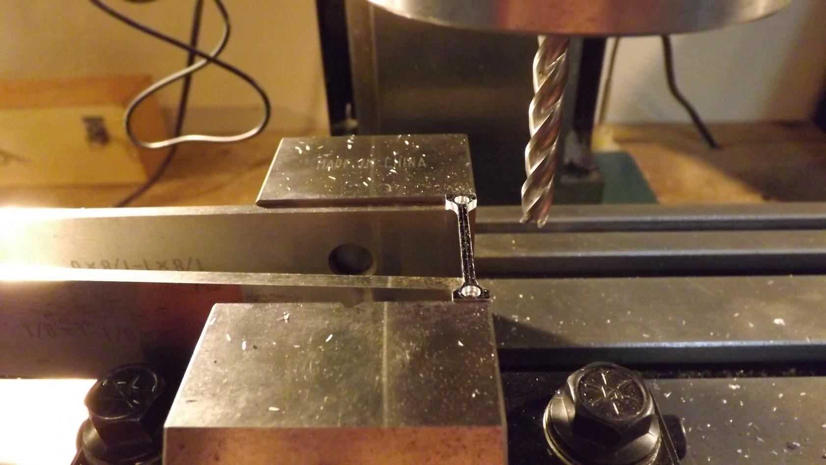

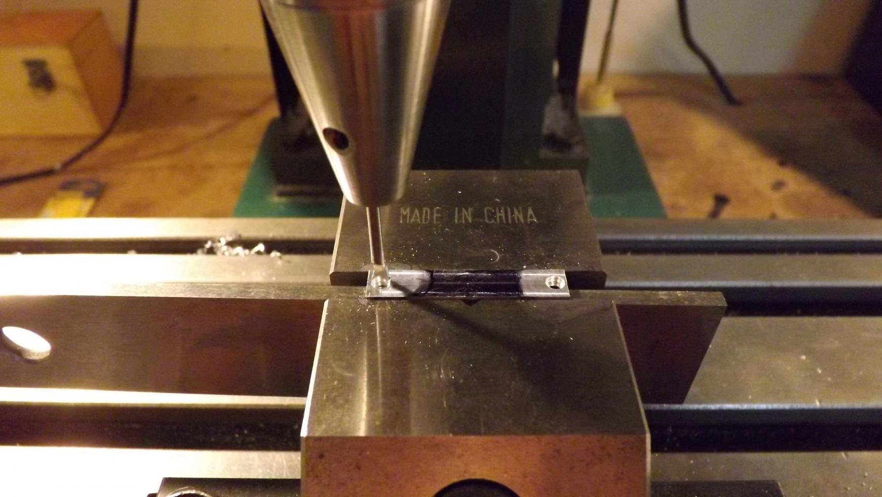

Did some machining on the servo arms. While doing so, I decided to modify my machines to take into account that I am not getting any younger. My eyes just don't like working with dials on the mill, so I ordered a DRO so I can more easily keep track of table movement. Dials just don't cut it, especially when lead screws have as much as .004" backlash. As soon as a direction is changed, the dimensions are lost. The DRO will prevent this from being a problem and will allow me to watch numbers, not count rotations of a dial. It will also allow me to watch actual table movement, instead of increments of screw rotation.
The lathe is also getting an overhaul. Head was taken apart, bearings cleaned and reset. The drive system is being overhauled with a VFD (variable frequency drive) instead of the stock step pulleys and clunky induction motor. The motor developed a vibration that conducted into the bed, which caused some pretty elaborate patterns in the cuts. Not good for making parts of any real quality. The original motor is a stock, Chinese build, which is not all that impressive. No sense in replacing it with another of the same. The new VFD drive will allow full speed adjustment without the need for the step pulley assembly, making the system smaller, lighter and more accurate.
I will not be making more parts until the upgrades are finished, which is about a week.

crazyhorse21: Thanks! I agree... it disheartens me every time I machine parts and see that laser etched 'made in China' on the vise. I would grind it off, if it wouldn't ruin the surface. I suppose I could Photoshop it out. :shame:
Machine rebuilds are in progress. Should be able to get back to making parts in about a week or so.

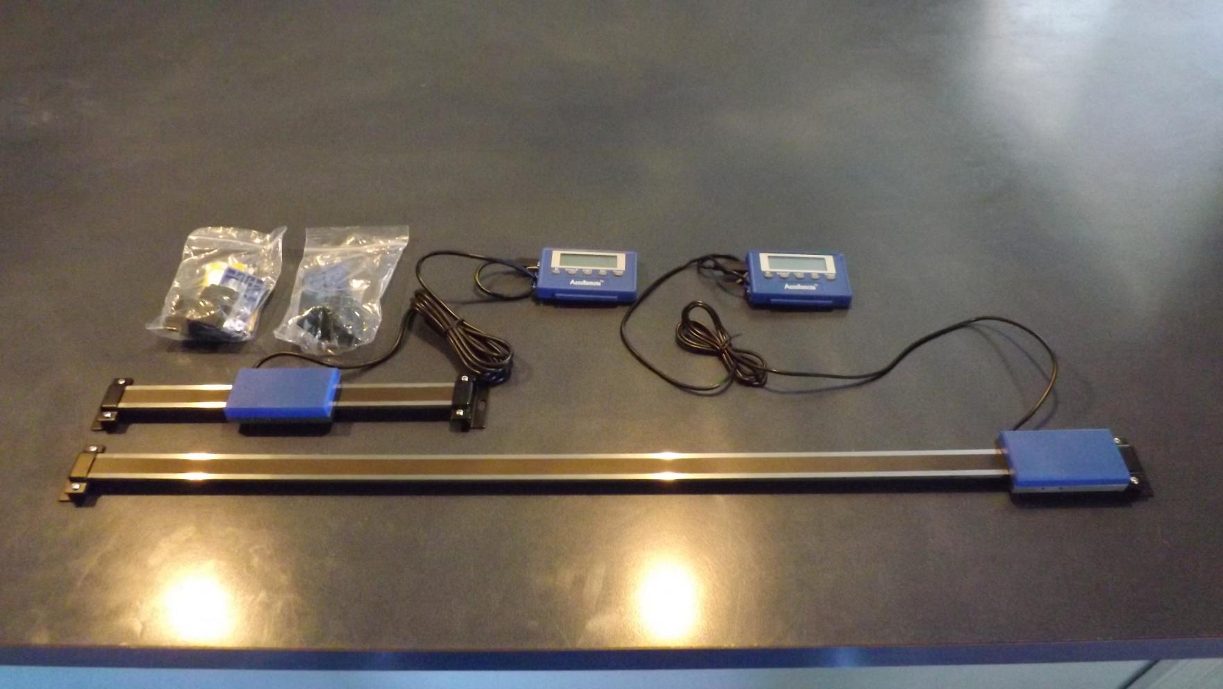

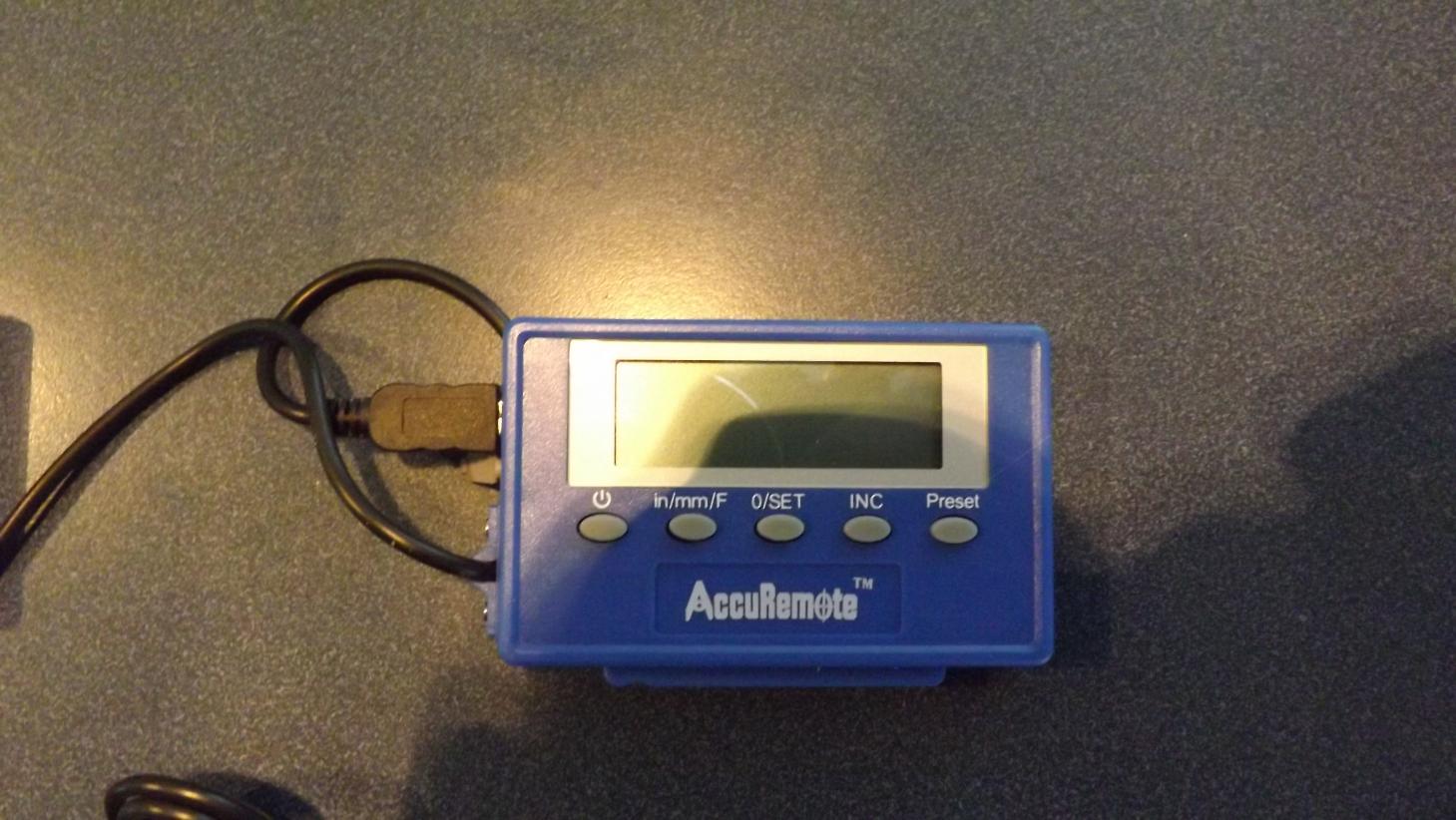

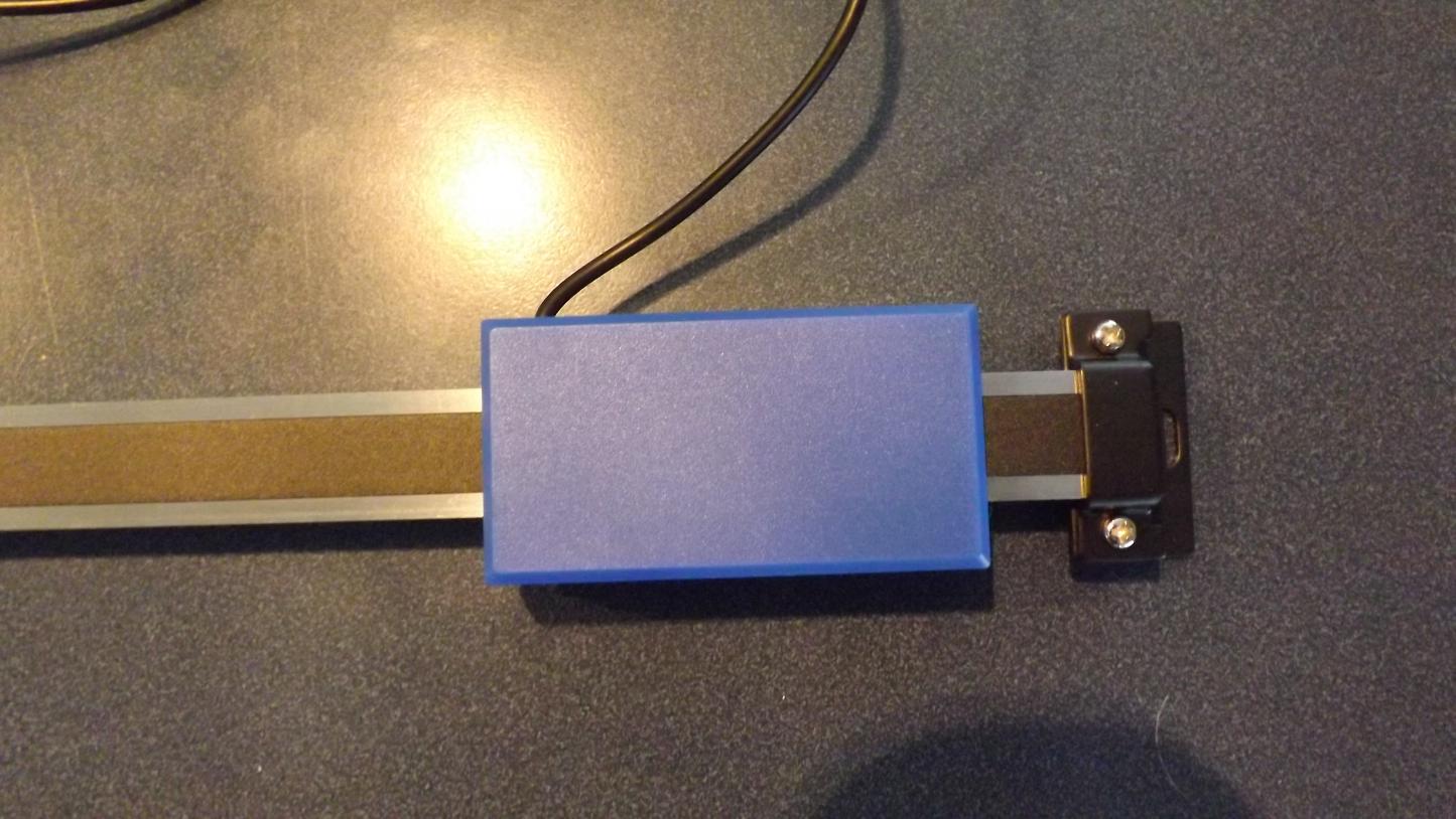

For those who have or want a hobby sized mill, here are two pics of the new DRO's that just arrived. No, they are not industrial grade... those DRO's cost about as much as the mill itself. I have used the DRO type seen in the pics, on my Z axis. It is functional and reliable. For hobby use, it is cost effective and works just fine. No need to go out and spend up to or over a grand on a professional DRO.
My machines are in a state of rebuild at this time. DRO installation on the mill and a complete drive assembly for the lathe.
View attachment 17631View attachment 17632View attachment 17633
