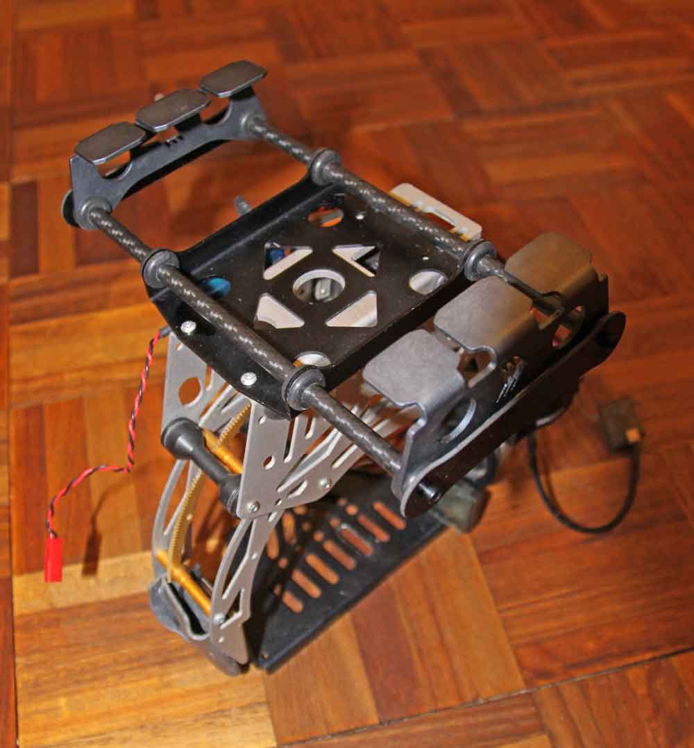

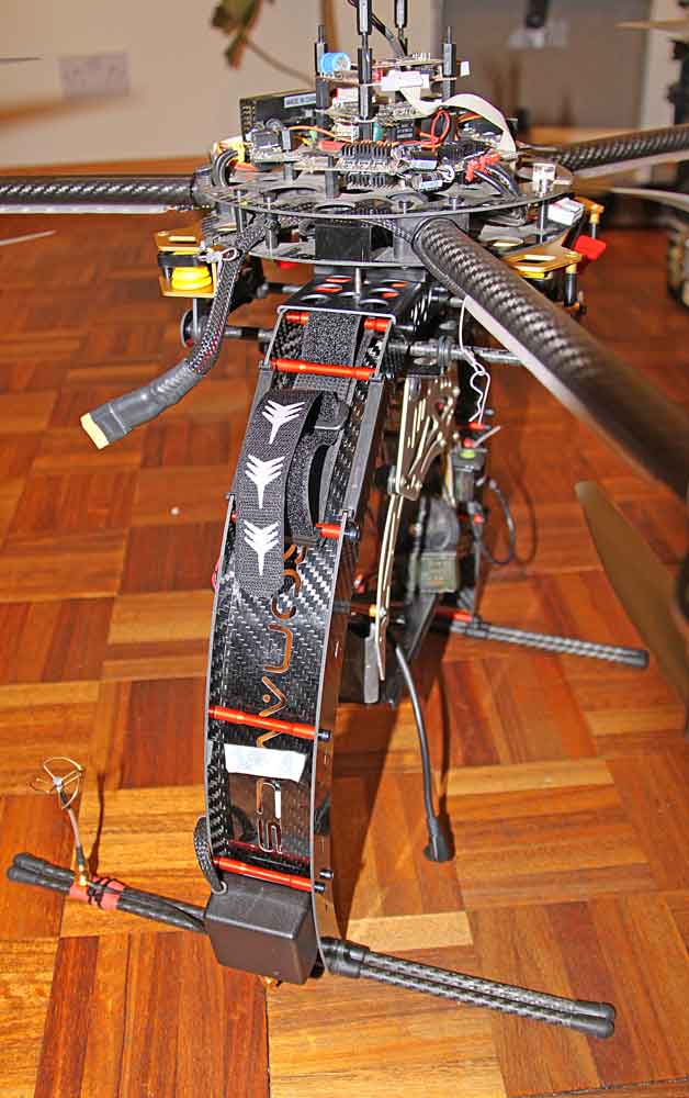

We've just started down this route. We went for all new undercarriage so out has gone the original landing legs and in has gone easily detachable landing leg assembly and vibration isolated gimbal mounting gear. We're in the middle of getting it all attached to the original AD3HX body, so far it has been pretty straight forward with all necessary mounting holes accessible without major disassembly of the electronics or such. What is taking longer is wiring up the new legs to take all the gear that's hung on them. Losing the horizontal gear rails on either sides of the old legs means rethinking how to attach equipment on the much narrower new legs. The thin bracing plate between the front and rear legs gives plenty of surfaces to stick things to, mostly velcro. You are forced to use dual, parallel battery packs, one on each side but thats no bad thing. The horizontal leg assemblies clip to the end of the legs with a good firm gripping clip. It's going to be interesting to see what happens in a heavy landing, will the legs unclip and allow the craft to topple forwards/backwards with prop impact on the ground guaranteed. Might zip tie them on. Looks like breaking down the whole craft for transport seems pretty easy and straight forward.
It's not a cheap upgrade but does make an older ( one year old !!!) craft look even more of the business. Biggest gains, hopefully are the improved vibration isolation and ease of breakdown.

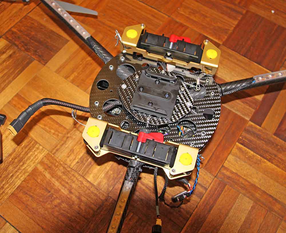

Its easier than it sounds. The new retracts mount to the main frame using an adaptor plate that acts as a small spacer creating room for wires, etc and keeping them isolated from the gimbal quick release. The new quick release iso for the gimbal mounts directly to the main frame, separate and isolated from the retracts. This allows you to break down the bird to a much more manageable size than in the past, at least the lower portion.
So now, the main part of the retracts stay mounted to your frame, with the legs coming off only leaving the small tabs behind. The new gimbal isolation allows you to remove the gimbal as well, again only leaving a small part behind on the main frame. Remember they are separate from each other.
