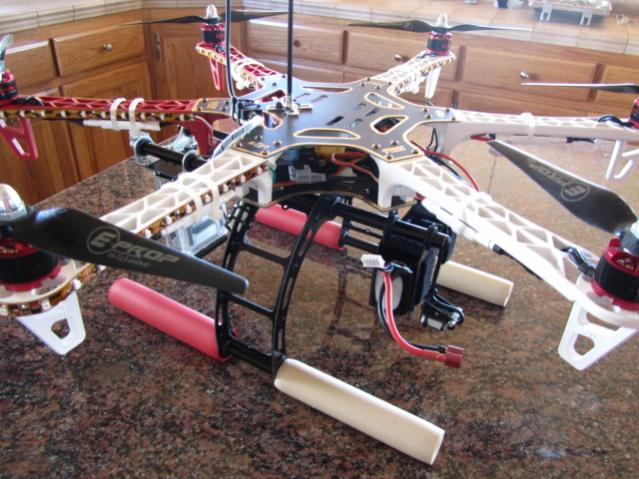

I'll post a pic of my setup tonight. I'm using a inverted V antennae and I have it taped to one of the arms with the open Y part facing the motor on the arm. Transmitter is 900mhz and 500mw power. Not sure if that causes any problems there. I'll take out the transmiiter and camera and see if I can get this narrowed down.

View attachment 5508I had two flights tonight with default gains, one with vide transmitter on and another with it off. I do more testing with the go pro when I get the mount fixed. I also noticed one of the arms was bent up a little. I bent it back and will try it out for the next flight. Thanks to Kloner, I checked my GPS offsets and I did have two of them positive when they should have been negative. I will report back later.

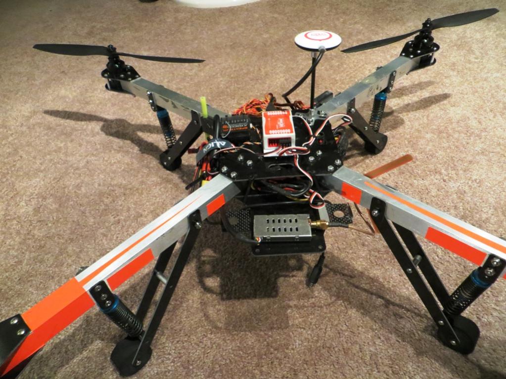

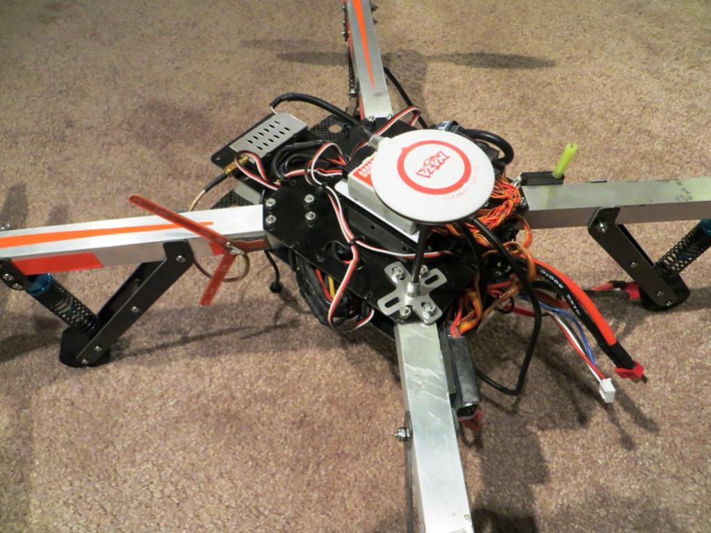

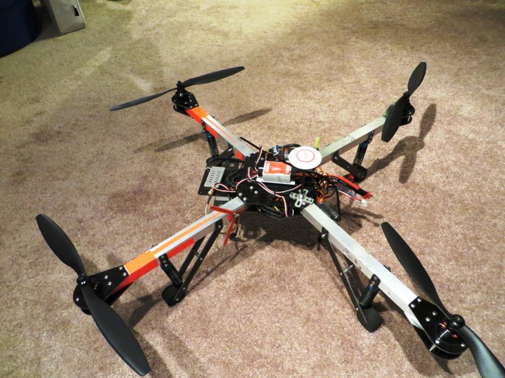

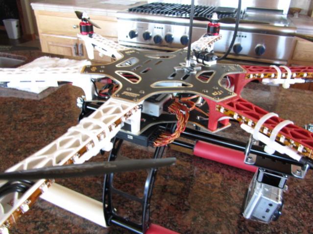

I htink i have seen filters for the 900 to prevent them from interfering with 2.4/ it would be brand specific,,,, got any pictures of the layout?

you got 10 lbs in a 5 lbs bag
i'm gonna make a short list of things i see wrong and we can go over em one at a time if you need more
the ar8000 is nestled in a grip of rx to naza wires = bad that antenna should be out in the clear and not near a wire for lets call 2-3cm for now since there touching as is
the inverted v would help if you can put it forward the arm, i know, doesn't seem like much but ever mm makes a difference
the sat is ok, i'd rather see it on teh front arm just to get away from all that wire and deans plugs,,,,,, not soldered properly makes em noisy. soldering them properly means solderd with a male and female plugged together than to let cool left plugged in. anything else doesnt work. easy way to tell is it should be easy to plug in and out
vu is really close to the gps, does it ever take a while to lock in and flash green?
those esc wires would love to be twisted like the red, orange and brown naza wires, all em actualy. the esc wires would be happier kept under the top plate and poke up at the last minute towards the front. will help keep em seperated from flopping where ever. some of em are there, but two are hanging out the side. carefullt split the three colored wires and roll em in your fingers. don';t force the twist, you can break the wire. what it does is makes a bunch of linear polarized wires like your inverted v and the ar8000 antennas into a not linear state by being crooked as hell
i gotta run a couple kids to school, but i'll be back with any questions and i'll look it over more. one thing i can't say enough is seperation, seperation, and seperation
one thing that i keep running through my head is how your using linear polarity antennas on everything. since there is a known problem with the video transmitter screwing with the rc rx, this would extremely benefit from circular polarized antennas, problem being the real estate were working with. it's too bad the antennas are 7" across, the problem with 900
With all that said i got an idea....... do you have the origional rubber antenna that came with your gear?
When a linear antenna isnt the same exact angle on rx as tx, they loose signal, get static. if your rc system was all 90 degrees and 0 degrees, a rubber duck at 45 degrees would help shift that frequency from hammering the rx signal so bad. problem is when you move forward and tilt, your gonna shift the video signal quality for the worst, but at least it's something to try thatn watch it fall over and over. I've only seen inverted v on planes, usually big ones that got lots of room for .... wait for it.... seperation
When you do get your filter, move some stuff around, versus going outside and flying it, read your radio manual how to turn down the 2.4 signal and check it all on the ground. I usually put the craft in manual so nothing flashes, then walk till i see the vu flash. way cheaper and wiser way to see if it works or sucks

Thanks for the detailed response. I can put the rubber antenna on the 900mhz video transmitter and see if that helps. I'll have to look at my DX-8 manual to see how I limit the range for a test. I think it would force the NAZA into failsafe. I have tested the failsafe function and it works great.
