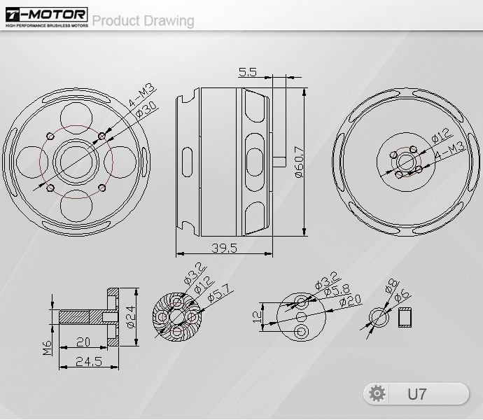

Hey Guys,
These Tiger U7's are huge. The traditional coax mounts wont work. I'm having a tough time finding some that will work. Anyone know where I can get some?
Here's Specs of the U7 motors:

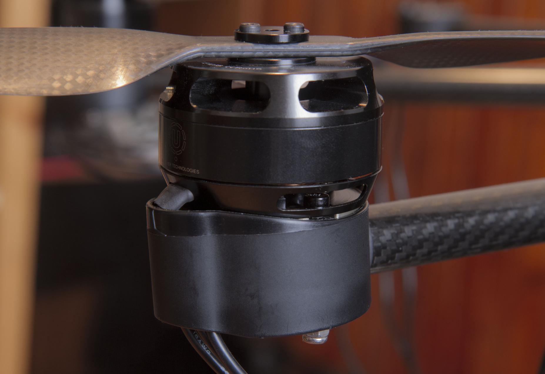

STEVE5
Mounting bolts are slightly inside the motor. There is two big holes, and special scruedriver is needed, but with carfully handling, because the winding of the motor can be so close to bolts. But it can be done.

You mount them on original plastic boom clamps and secure them with 4 screews. Easy and good solution with coax support also.

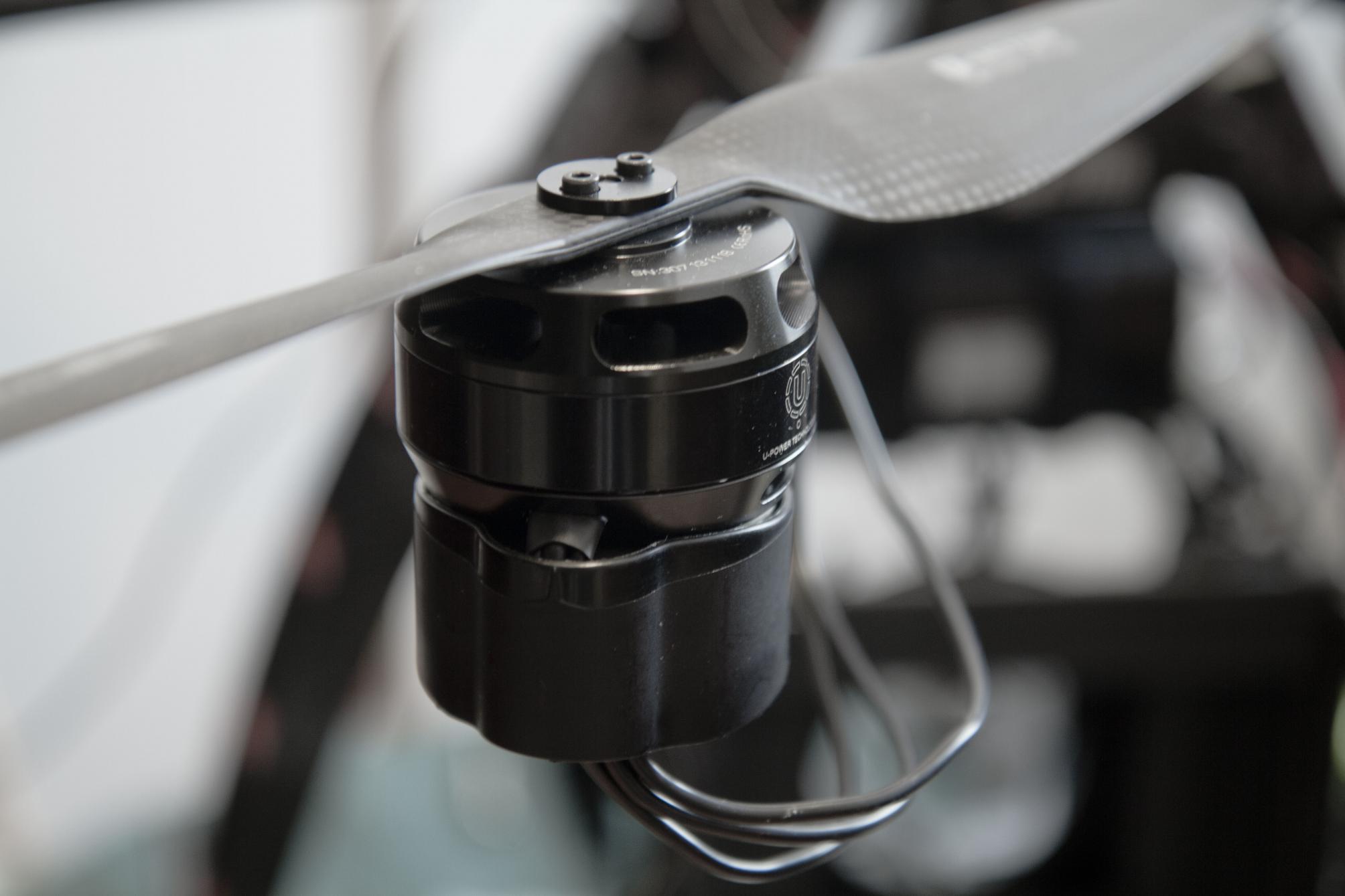

STEVE5
Hi to all,
this is my fine tune of DW SJ mount. Also usable for coax mount.
attachment.php
PS: srew is screw, sorry for bug...
