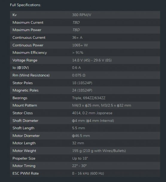

KDE does not show any technical data for the 4014 at 4s on their website. Do you have any data?
No - I just trusted eCalc and took a chance that it was right. So far eCalc has been spot on with my setup. I'm not saying that the 4S/17" setup is the most sporty - I have the gains set pretty "loose" since this is my floaty, loiter mode. I run at 6S with 14" props when I want to be a bit more sporty. I'm getting just over 20mins with that setup. I flip back and forth between the modes: I have self-tightening adapters on the props and the FC configurations are saved and take just a few seconds to upload. The gain settings are rather different and of course the voltage warnings have to be set right for different the batteries. But swapping modes takes no more that 3 or 4 minutes with the most fiddly part being unstrapping the batteries.
