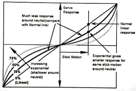

Expo is not more or less control. You still get 100% at the ends of the sticks (if you have your end point set to 100) Expo changes the amount of travel from linear to either accelerated or decelerated curves.
Check this:
