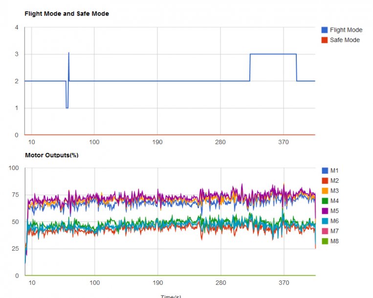

Here is my last flight today. 322 to 389 seconds was in GPS.
I lined up the motor output so graphs correspond. Spending too much time on this. SuperX & MiniX are about the same on this Hex except for MiniX show more vibrations... Going to take my Naza V2 off and give it a go on this frame. Will go by engine temps as the 1,3,5 motors are luke warm and 2,4,6 are ice cold (it was 11 degrees when I was testing today). I have to be missing something really simple. If Naza does same thing then I'll swap 2 arms and reverse directions and see what happens. This will switch both the motor and esc, but me thinks it would be an exercise in futility.

First two times I check level was on the motors. Checked level on motors for 3rd time. Put the MR on the floor, put props 90 degrees to it's arm and them measure from the floor to the tips. 1 motor off a bit (which was the hottest of the motors and 2 nd off alittle). Flew better today, changed to Naza, with motor temps not so crazy between even and odds. Sounded the same flying, but better on hoover. Will put SuperX back on so I can check logs. Guessing I need a new way of leveling motors.. Thanks for suggestions....

I saw that but I don't remember what he did. I also think his arms were flat, not pitched up 6.8 or so degrees. Just went to you tube and only found his hexcrafter with iphone or droid phone, which is how I did mine originally. Baffling. I'm wondering if it's me or the props. When I put the SuperX back on, will check the props and motor one more time. Might make a stand to hold arms as retracts aren't 100% film in keeping the frame still and level.
