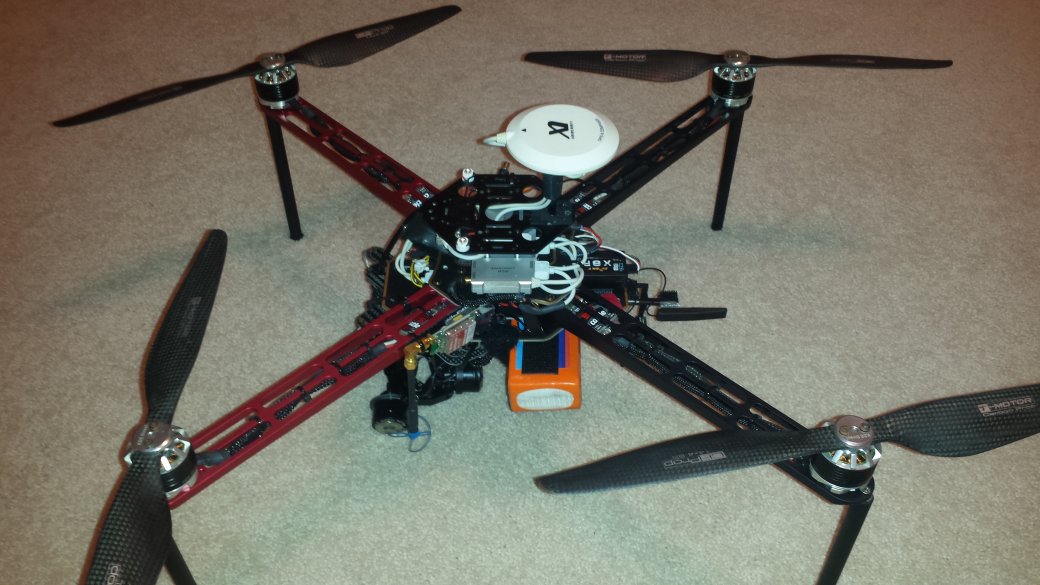

Hello! Yesterday I finished assembling my M480 with SuperX controller and now every time I takeoff, regardless of flight mode my quad will start a slow left rotation while holding position. I calibrated ESC's, radio calibration also accomplished, as well as the initial setup and all Super X calibrations by the book. Could I have a bad ESC? I did noticed that every time the left yaw rotation started I could hear one motor accelerating slightly higher than the rest. When rotation starts there is nothing I can do to counteract, except land.

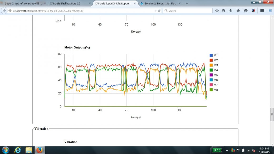

Your motors are not aligned. Look at your motor outputs and compare them to mine and you will see.

fltundra
Even when his sticks are centered . His motor outputs are 40%spread. M1 and M3 are fighting against M2 and M4.
