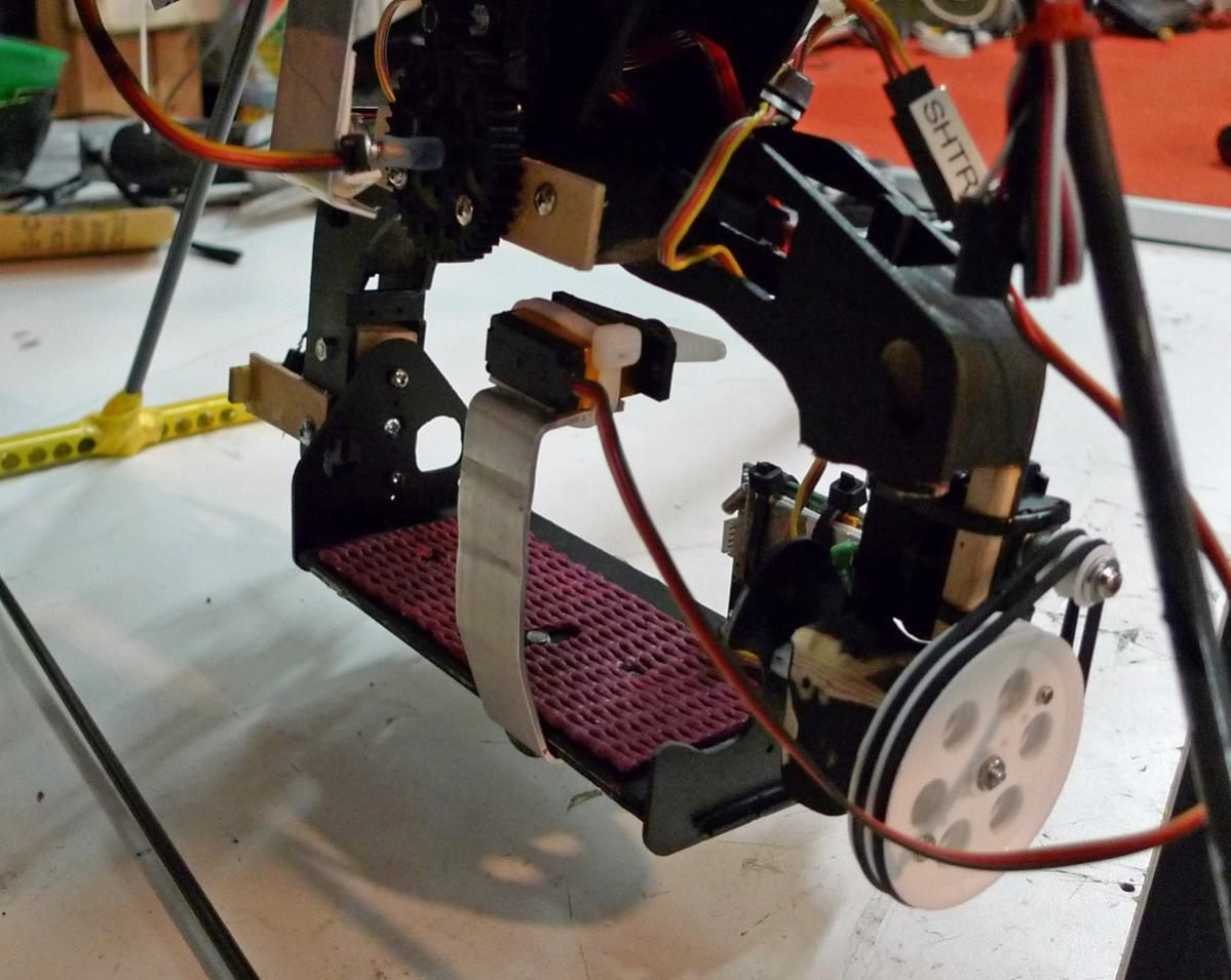

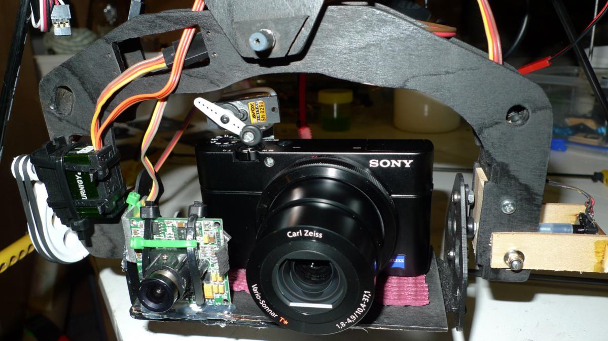

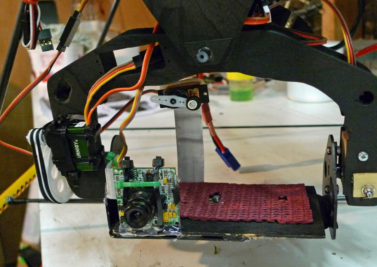

Efliernz
Pete
Have you tried the HDMI out with ant converter yet?
I have a separate Sony 1/3 CCD connected to my downlink. With the HDMI socket underneath and near the 1/4 thread, It will be difficult (but not impossible). I have only sorted the shutter so far (Stacky had to go and wanted to take his camera with him) but I suspect I'll dable with the zoom control too.

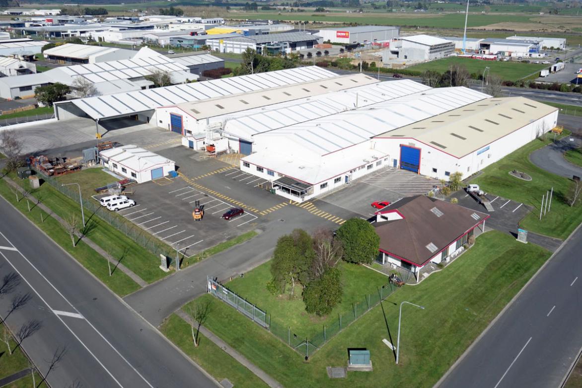

Working photos...
I don't have a HDMI-Comp converter so I used the "spycam" system. I will need to change spycam lenses to give a less wide representation (or get a converter) as I was off-centre on a few photos.
I shot solo (without my camera operator) and wore "Eyetop" video glasses giving me a monitor for the sideways-look on the right eye.
All 190 photos were in perfectly in focus - stunningly good . 1/640 Shut-Priority, 200iso and "Continuous-shutter".
I had the focus set to Single-shot AF (AF-S) as I found the Cont-AF (AF-C) was "hunting" the whole time and not always in focus a good as AF-S. AF-Cont shoots once a second, AF-Single shoots 3 times a second in continuous-shooting mode.
Verdict from the first proper shoot. I love it
