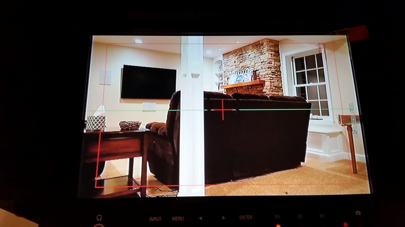

Ok so here are some pictures of the screen, Unfortunately it is a picture of the screen taken on my phone, I couldnt do a screen capture on the liliput. Then the real picture is there to compare. The screen is pretty good you can easily see what you are getting but to use it for true focus, colors, etc .... may not be the best. These are obviously in the house it was too dark to fly when I got home.

Thanks Owen! It looks about on par with what I am used to with my AV out of the Canon. As you say good enough for composing the shot. It's a shame there aren't any systems in between these and the Lightbridge et al. Someone could clean up if the made a product in the $500 range that would do 720hd throughout.
No big deal though. I've been happy enough for the past few years.
