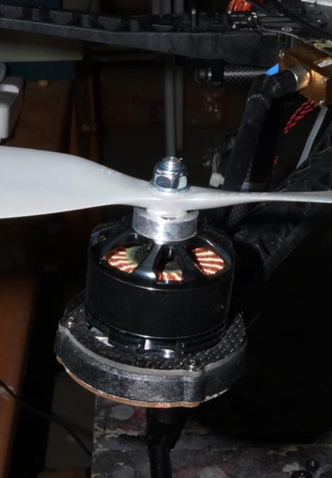

Yes I will sell some, but they were made in Cyp. not China so each set is in the order of 50 euro (set of six.) High grade aircraft alum. View attachment 6387
I wont be upset if anyone copies the idea.

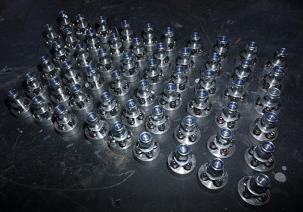

View attachment 6408View attachment 6409
Only two sets left now so guess I must make a few more.
As you can see the set comes with a nice fitting washer and nylock nut plus proper cap head HT screws and not those crappy DJI ones that you can use once if you are lucky. Hi grade aircraft grade alum. but don't forget a little light grease on the thread. Don't overtighten. The reason I made ten sets in the first place is because the cost is about the same as making one set.:tennis:
