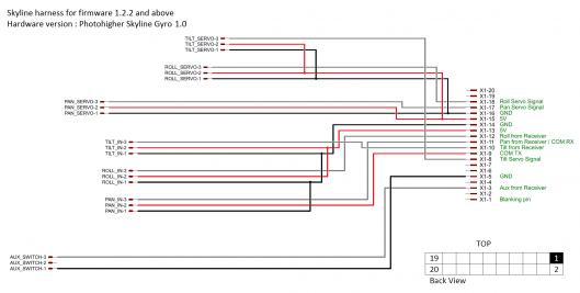

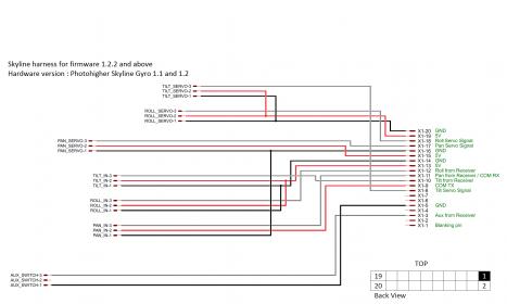

Is Photohigher sending out new wiring harnesses with dummy pots to dealers? I contacted the dealer I got it from and they acted like they don't know what I am talking about. I bought my RSGS during pre-order and have never even had it out of the box, figure if I have waited this long I can wait for a new harness. I know I could do it myself but I don't have the time to sit down and do it. I rather just get one ready to go, I also feel like I diserve it since this thing didn't work out of the box as advertised.
Thought I read they were but maybe I'm wrong. Sorry if this has already been asked.
Hi Mactadpole,
I confirm you that Photohigher have send the new harness and dummy pot to their resellers. I'm actually sending these to my customers.
If your reseller don't know about it: ask him to contact photohigher quickly.
If you are in emergency and can't wait to have it, it's very easy to build one.
you will need :
- 4X 2.2Kohm resistors
- the version number of your skyline (written in the top right corner of the connector on the skyline)
- your actual connector
- wires, servo plugs
- one of these two scheme
View attachment 6868View attachment 6869
Hope this will help.
Best regards,
Cédric
