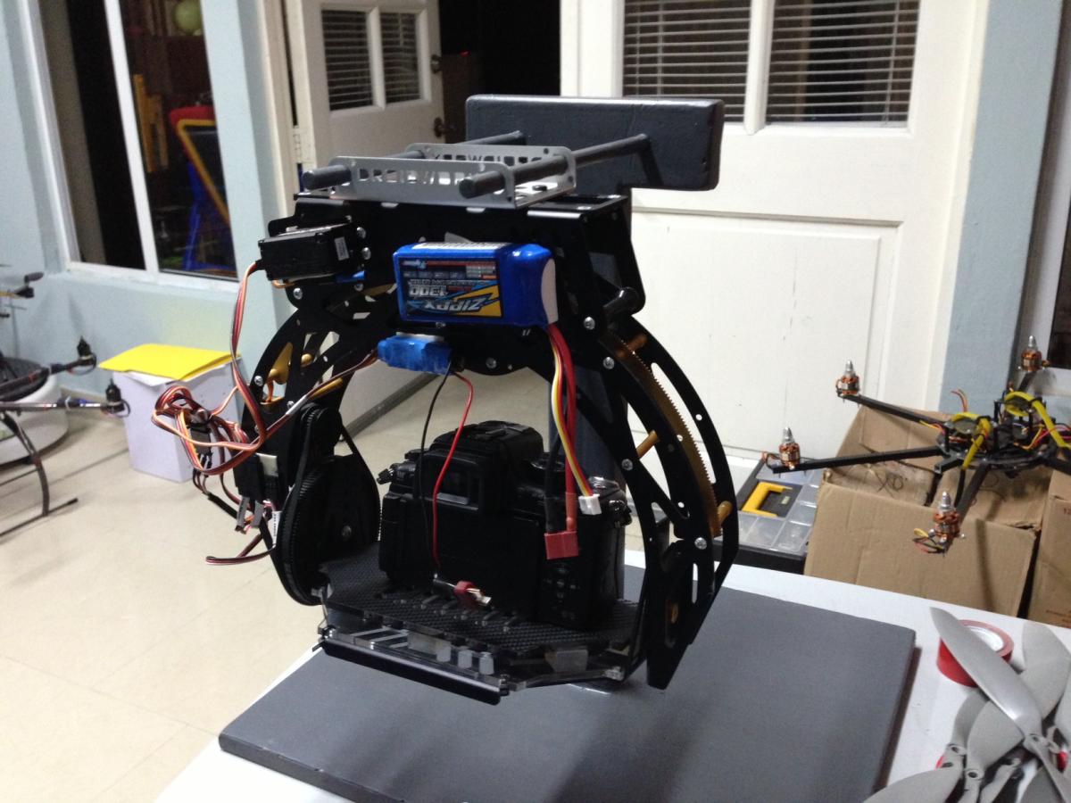

Work has kept me busy till now that i made this mount to setup and calibrate rsgs.
I installed the version beta 1.7, seems to install and perform well on the bench.
I'm using the av200 with a panasonic gh2.
Anyone has this configuration that could share some experiences with me?
