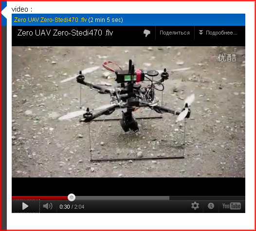

Hi there :)
Servo used on AV130 and AV200 are SAVOX 1290 TG (titanium gear) and 1256 MG (metal gear).
The MOST important thing for a good stabilization is a very well balanced gimbal.
About the 550D: its fit in the AV130 but you will have to buy a corner cable for video output. You can find some on ebay if I'm not wrong.
Thanks to Darko I have read about this new shaft. I will have an order this week end to Photohigher, I will ask them about this shaft.
For pan mounting I really prefer the helicopter cross system
This allow a larger clamp on structure but you will need a dedicated adaptator plate between your multi and this cross plate.
