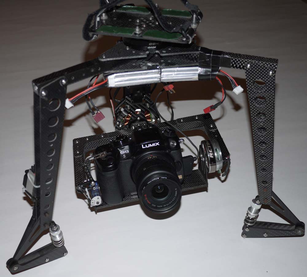

1 sample of aerial photo using of 14-42. Notice :Fog in image because of polution (industrial area) not from lens quality
