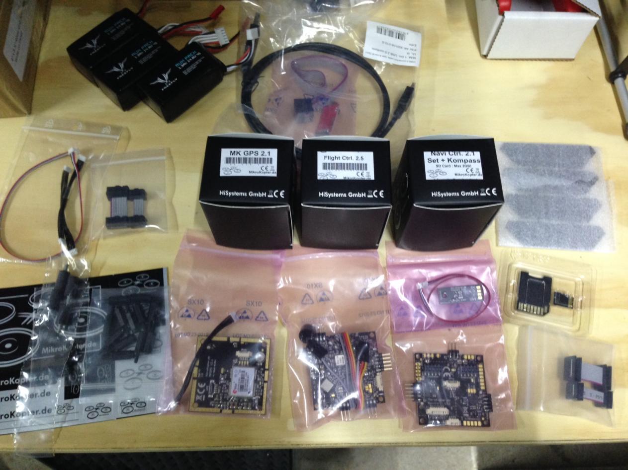

Postman turned up today :)
attachment.php

Hey Baja,
I've just swapped to MK too and looking at wiring up the herk. Do you have a ribbon cable connecting top + bottom board, and then just the white molex to the FC 2.5? Or do you not need to connect the top + bottom boards with the ribbon cable? (If so.. did you cut the ground wire on it like the diagram?)
Cheers,
Cam
baja-king
Here for the ride :)
Hey Baja,
Cheers,
Cam
Hi Cam,
AFAIK you have to connect the upper and lower boards with the micromatch cable and then just connect either board via the I2C lead to the MK FC. I don't think it is necessary to cut the ground if it is already grounded by the power wires (like the negative earth on a car). I will shoot Andreas an email just to check. Did you go for a new MK 2.5? :)
baja-king
Reply from Andreas:
"Hi Steve,
1) Connect with 5-pin molex cable from FC to Herkules top Molex (white connector)
2) Use flat ribbon cable (8-pin) between top micromatch (red) and bottom micromatch (red)
That’s all.
You can remove in the flat ribbon cable (2) all pins (3-8) and use only I2C_SCL and I2C_SDA. But its not a must. Its working with GND also perfect. This only simplifies the wiring effort and the flat cable becomes thinner to be easier routed from top to bottom.
You don’t need GND as the OKTO_XL board is already connected in the center with GND and VBAT.
BatCam
RPAS Pilot
Hi Steve,
Yep I talked with Andreas too, he is always so helpful! Cutting the cable makes it much more flexible which is nice.
I'm installing on my SkyJib frame, I think you sold yours, but if you were doing the same, would you put the GPS+GPS Cover above the cage? I assume having the crash cage over the GPS board wouldn't be desirable..
baja-king
Yep I'd put it on top of the crash dome, or you can mount it on the arm as some do.
