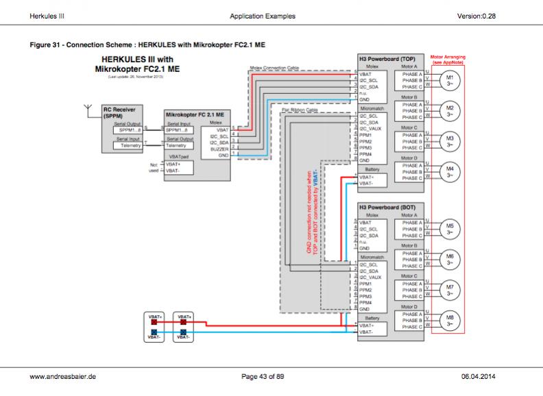

I want to use it with my Herkules III so I'm judging by the manual that I will not need the BL 3.0 speed controllers?

Baja, you can use Herkules III with Mikrokopter flight controller as I do :) You install the latest Herkules III I2C firmware 1.06 and thn you're good to go. You will not see a difference in flight performance. I also use BL Ctrl 3.0, 2.0 on various copters.
