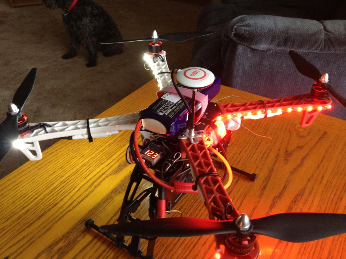

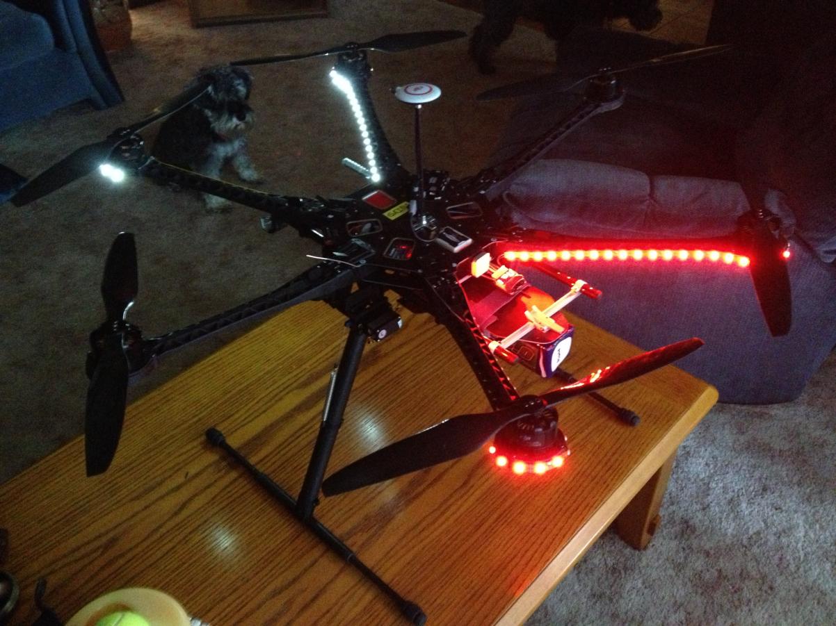

I want to put a single or maybe 2 bright white led on the front of one of my multirotors. and then want lights on the bottom of one of my other MR'S Is there a switch I can put on board that can connect to one of my receiver channels to turn them on and off remotely?
There are single LED solutions out there, but by and large you will see almost all operators go with an LED strip for great improved visibility at all times (including daytime) even when the aircraft is out 100 meters. I personally run my LEDs all the time, including daytime, and really helps orientation. I do white in front and red in the rear and I know a lot of operators that do that, but I do know a few that reverse that, and each having their rationale for that choice. It'll be your personal preference.
White LED strip: http://www.rc-drones.com/white-orientation-LED.php
Red LED strip: http://www.rc-drones.com/red-orientation-LED.php
Control switch: http://www.hobbyking.com/hobbyking/store/__8833__Turnigy_Receiver_Controlled_Switch_.html (though I don't use one)
O and maybe something that can control them to strobe or even blink in a pattern?
I would search HobbyKing.com for that. Here's a quick one I turned up, but reading it I'm not too sure it's what you wanting:
http://www.hobbyking.com/hobbyking/store/__6811__Lumifly_Lighting_system_FAA_Configurable.html
View attachment 12537View attachment 12538
I should add... the benefit of the strip is that you can also tell from the light strip if the aircraft is flying away ('V' shaped lights) or coming towards you (inverted 'V').

Ya ill definitely need to know orientation for night flying.. ALSO does anyone know if the new 3rd gen Fatshark Dominator goggles work with the TBS lawmate 2ghz receivers like the 2nd gen did?
