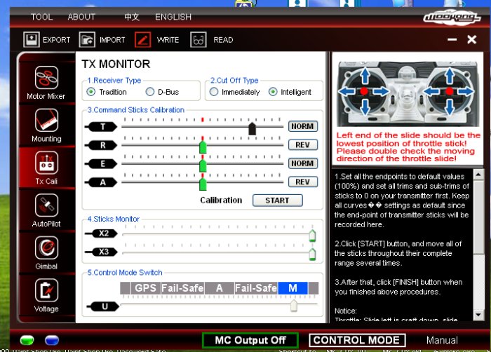

Geoff I believe my problem is in the way I have the 3-way switch set up. When I move the switch to the lowest position I see fail safe displayed in the lower right hand corner of the assistant. In the center position I see attitude and in the up position I see fail safe once again.
All sticks work as they should with the correct travel in assistant

Buzzed, set the ATTI or center position first by adjusting your sub trim. Then adjust the end points to get Manual and ATTI/GPS. The positions need to be high lighted as well as showing the proper readout on the lower right corner of Assistant.

Yes as ED says put 3 way switch in middle first then sub trim it so it highlights Atti , then move switch to top position and then adjust with Travel adjust or EPA to light up Manual or Gps Atti ... Then do same for bottom Position.
You will need to use both sub trim and End point Adjust to get all 3 highlighted when selected.

I seem to now have the GPS Attitude/Attitude/Manual now reading properly. Shouldn't I see the MC Output as On to start motors?

Buzzed, you cannot arm the motors while connected to the Assistant. No motor test like in MKTools. I assume that you have the props off. After you disconnect Assistant from your WKM, repower and arm the motors using CSC. The motors will stop in 3 sec if you do not increase the throttle to greater than 10%.

Boy do I have a lot to learn. Followed your advice Ed and got a motor start. YES!
