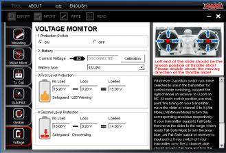

I'm having a problem of my VU start blinking red within a couple min of flight... when I check battery voltage its on 15.6 which is too soon according to my config.
Any tips?

we kinda replied at the other thread. no gps right? if it is sagging like tstrike said under power then not when hover, your batt are saggining into lower voltage than you expect. Could be the prop changes
drop 14.8 to 14.6 and land early, don't wait for it to tell you too

on page 39 is shows the condition as low voltage or other errors....... this starts after your flying right? do you have any other packs around? do you have a way to read the packs internal resistance? if not, balance charge the pack, leave it hooked up for a while after so it can leak down if it will and press the right button to watch what all the voltages are, come back and tell us what it says. i'm looking to see if they hold all the same or very different
