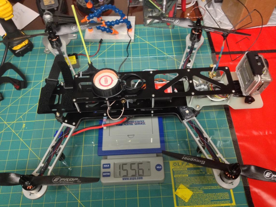

Coming back to this thread - I'm ready to buy a QAV500 and move my Naza over. How are the latest builds? Do people still have problems or does it depend on the motors in use?
gecf343b1
I recently built a QAV500 with Sunnysky 2216-12 KV800 motors, DJI opto 30 ESC's, and a NAZA FC. This combination doesn't seam to play nice with the NAZA. Haven't bent any arms just a few broken props. Messed with the basic and attitude gains on a slider, 10 and 9 inch props, could not find a combination that removed vibrations, and felt dialed in.
I think I'm going to hangar this bad boy and practice setting up and tuning a CC3D on a smaller frame; then when I feel more confident I'll try the CC3D on the QAV500.
