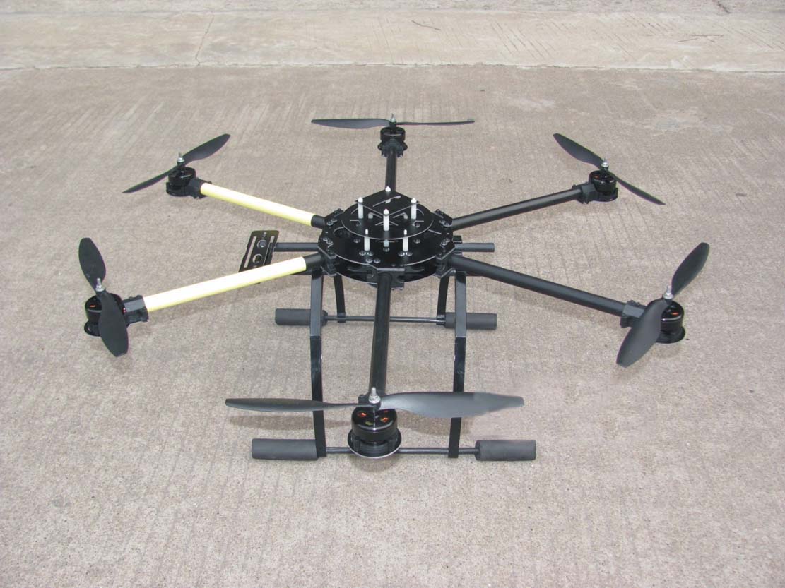

Rusty's UAP2 Y6.
Great rig!

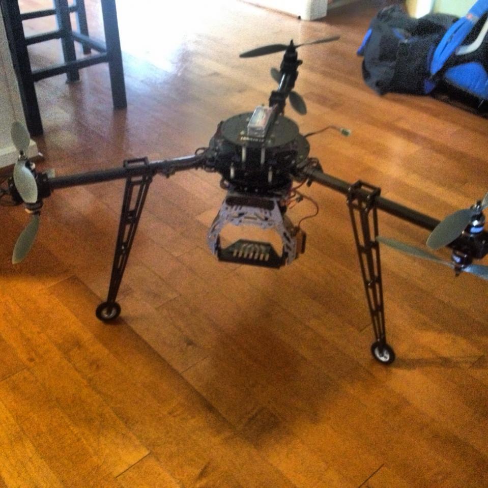

Sorry for the delay, I am having a busy week.
I'm running 12/38 APC SF on top and bottom, but I'm thinking of running APC SF 12/38 on top and 12/4 on bottom. The rig is 850mm from motor to motor.
I also tried the Gemfan 12/4 wood props, and they took quite a bit of effort to balance but I do like them as well.
Also, I made a change to the rig. The way the gimbal was mounted the landing gear were causing me some vibrations, so I changed the rig around, got some "Finestar" landing gear (fake cinstar)
And I now have this... I only made a quick hop, but the video looks pretty nice. No vibrations now...
View attachment 11033 View attachment 14056View attachment 14057
