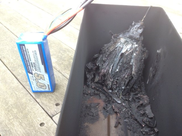

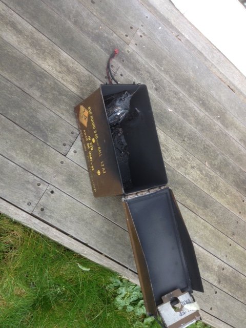

Learned why i must ALWAYS charge my lipos outside.
Last night i charged a 4s 5000mha lipo on my icharger 3010b and chargery 1200w Power supply. For some reason it didn't cut off and the lipo exploded, luckily i always charge the lipo in an old Ammo box so the flames didnt take anywhere. but the smoke was insane, i went to A&E as breathed in alot of smoke while shutting of the power and trying to open the doors/windows. my house was a mess full of soot in every room still stinks of poisonous gasses. Girlfriend with ruined clothes maybe more dangerous than the lipo fire to be honest.

Can't tell from your pics, but how many exploded and are they all ruined?

Only one lipo luckily and yeah it's toast
I know i feel the same i know keep mine in Lipo safe bags inside metal 50 cal ammo box in plastic chest in the mini shed my lawn mower is in in my garden. I'm too scared to keep 10+ lipos in my house since my fire.
