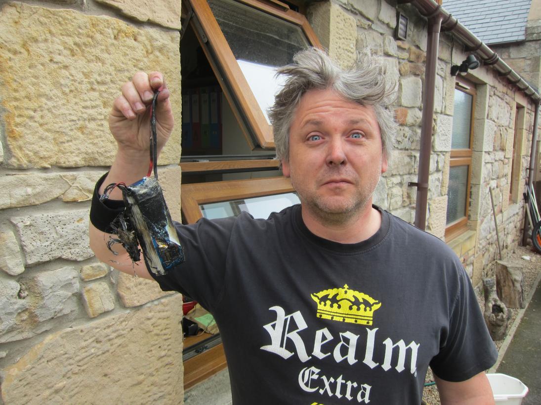

View attachment 12416Just to drum home the dangers of these, just had one explode under charge, charging in the house with no lipo safe bag....idiot!!
Lesson learnt and luckily I was right there to handle it and just far enough away not get burnt.
Lucky day, and a good lesson learnt.
Be careful with your lipos everyone.

Lucky. I have a heat sensor on my charger and I place the lipo in a metal pan while charging it. I had a 6000 mah lipo get punctured after a crash. I didn't see any flame, but I could not believe the amount of heat that came off of the battery.
was it ever crashed or abused where the ir was high? yikes I do mine on a tile counter near a stove but man, the smoke from them things is like a smoke bomb and it stinks forever. something happen with the charger?
Not sure what happened Kloner, I wonder if a contact from the balance plug touched the rim of the tin tray the battery was sitting on. I always make sure and tape those up when the batteries go into storage for a while. Charger seems fine not indicating anything wrong and working OK. Never been crashed ,but has been abused on a couple of occasions where I drained to far.
