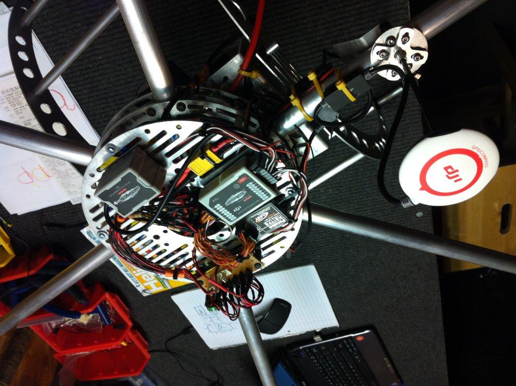

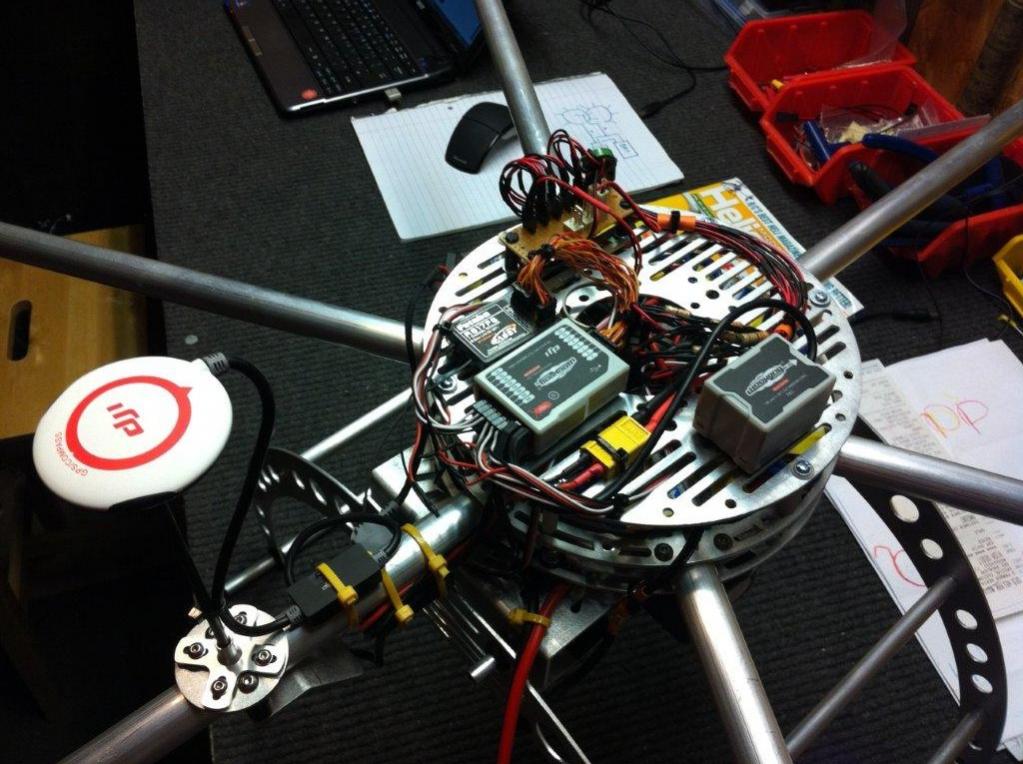

I was hangin' with Emowillcox last night and we were trying to figure out how the different components of the WKM should be fitted to the frame plates of the quad he's building. Can someone please post a clear picture of a WKM installation showing the position of the various components?
If someone wants to put together a quick rundown of the components (w/ photos please) and what they do I'll stick this thread in the DJI Forum for newbs to get started with DJI.

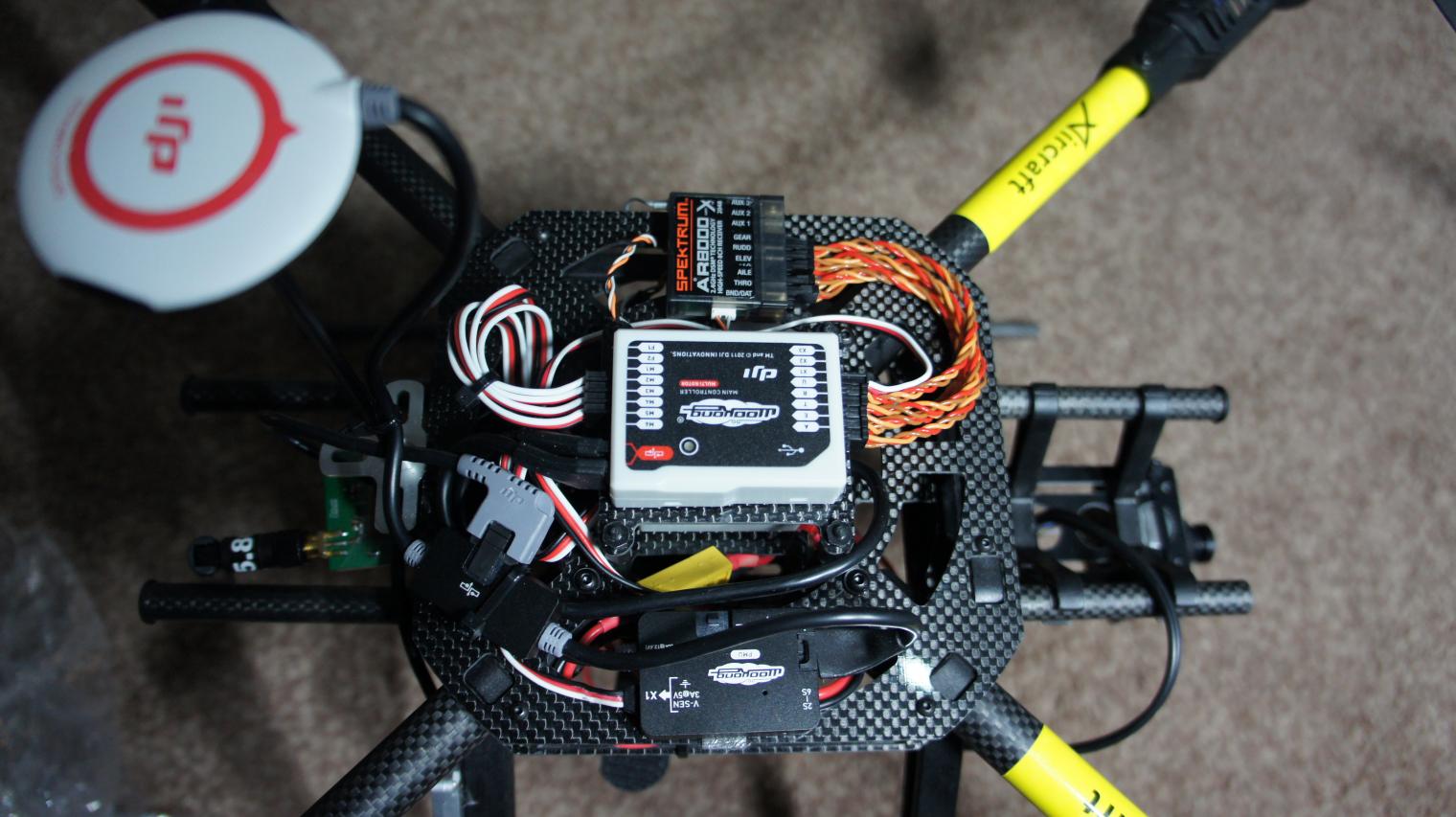

Hi This is how I have laid the electrics out on a X650V frame and it works well for me .
View attachment 1286View attachment 1287View attachment 1288
Basically on this frame , I first have the IMU on a mounting plate , then above this on another mounting plate raised with nylon pillars sits the MC .
The Gps module is on the tallest rod and is about 5cm behind the MC and the power module is on the right hand side of the frame and radio receiver is on the left hand side.
The Led is mounted to the rear of the quad at the top of the landing gear so is visible in flight.
Hope the pics help out.

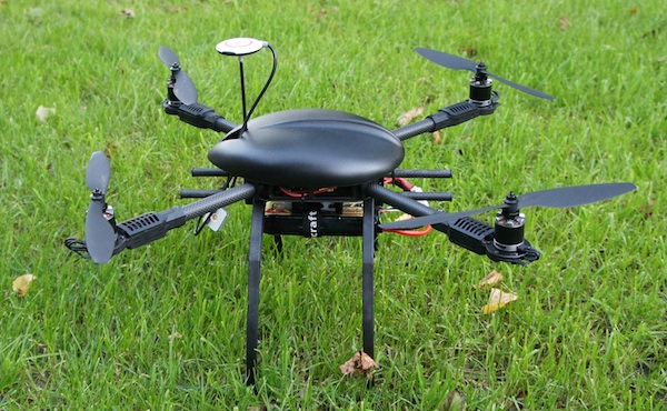

Heres mine I threw together.. Now I know how good it is Ill be making it better till the CX4 is available
Emo you are going to LOVE it
attachment.php
rwilabee
What kind of frame and motors are you using. Looks really sleak.
Rich

Hi The Frame is Xaircraft X650V Carbon folding frame , and the motors are a 880kv I am currently testing before having them produced for my branding .
I have just taken delivery of a large batch of 3536 size motors today and they are superb and I have branded them Torxpower 3536 Pro.

I was thinking about going to this frame (if I can find it) and reusing the stuff I have which includes the WKM. Did you make those plates for mounting the GYRO and IMU as I'm assuming there are to many holes to just double stick tape them down. Did you use their motors and esc's. I have motors and esc's but I don't know if the esc's would fit in the arms. Mine are 30amp

i have the frames coming in stock this week , probably back end or very early next week , and it came with enough plates to mount everything as you see it .
I did not use there motors , and there esc's cannot be used as they are ultra pwm so will only work with there controller.
30a esc's might not fit perfectly in the slots as they are a bit bigger , but they will still be able to be mounted there and still be neat and tidy .
Geoff

Looking at some of the pics here I can't see how you could lay that out with the wk-m and FPV. Can you send a picture. I just want to be comfortable in my mind before I start ordering the quad.
Rich
Yes definately as i have FPV gear on mine .

Hi Geoff...
Did you cut out the cover for the antenna to come up thru. If you cut it out you did a clean job no sure what you used.
