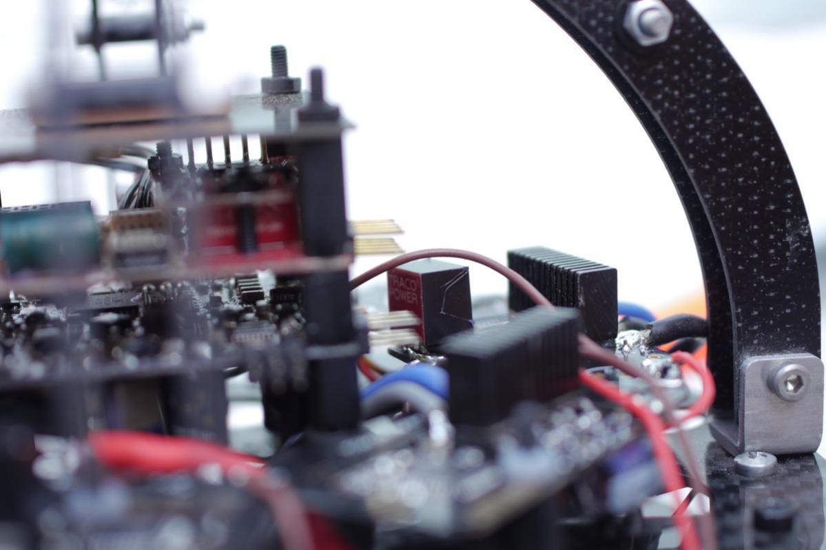

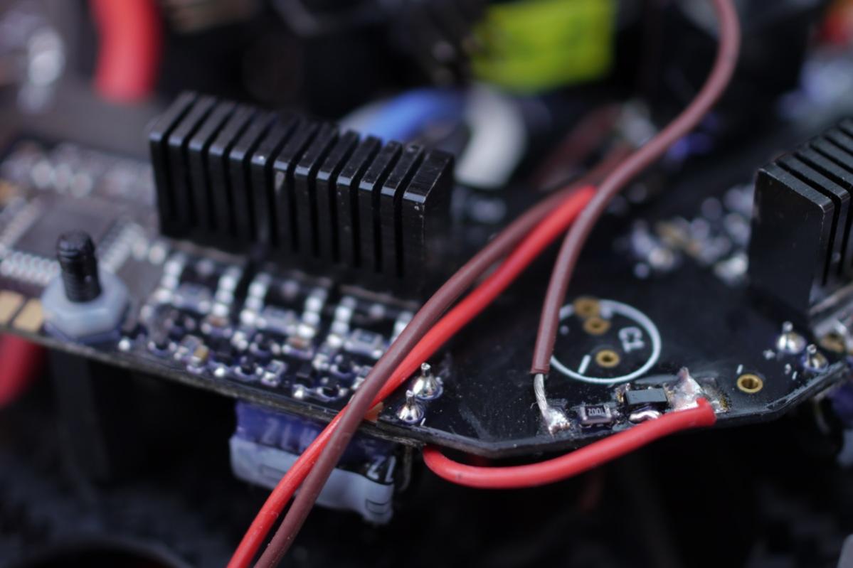

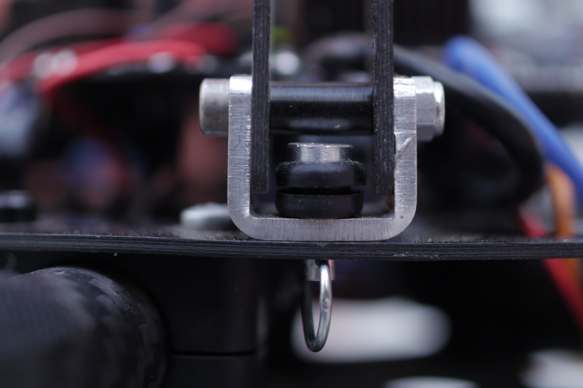

Hi This is how I have laid the electrics out on a X650V frame and it works well for me .
View attachment 2159View attachment 2160View attachment 2161
Basically on this frame , I first have the IMU on a mounting plate , then above this on another mounting plate raised with nylon pillars sits the MC .
The Gps module is on the tallest rod and is about 5cm behind the MC and the power module is on the right hand side of the frame and radio receiver is on the left hand side.
The Led is mounted to the rear of the quad at the top of the landing gear so is visible in flight.
Hope the pics help out.
