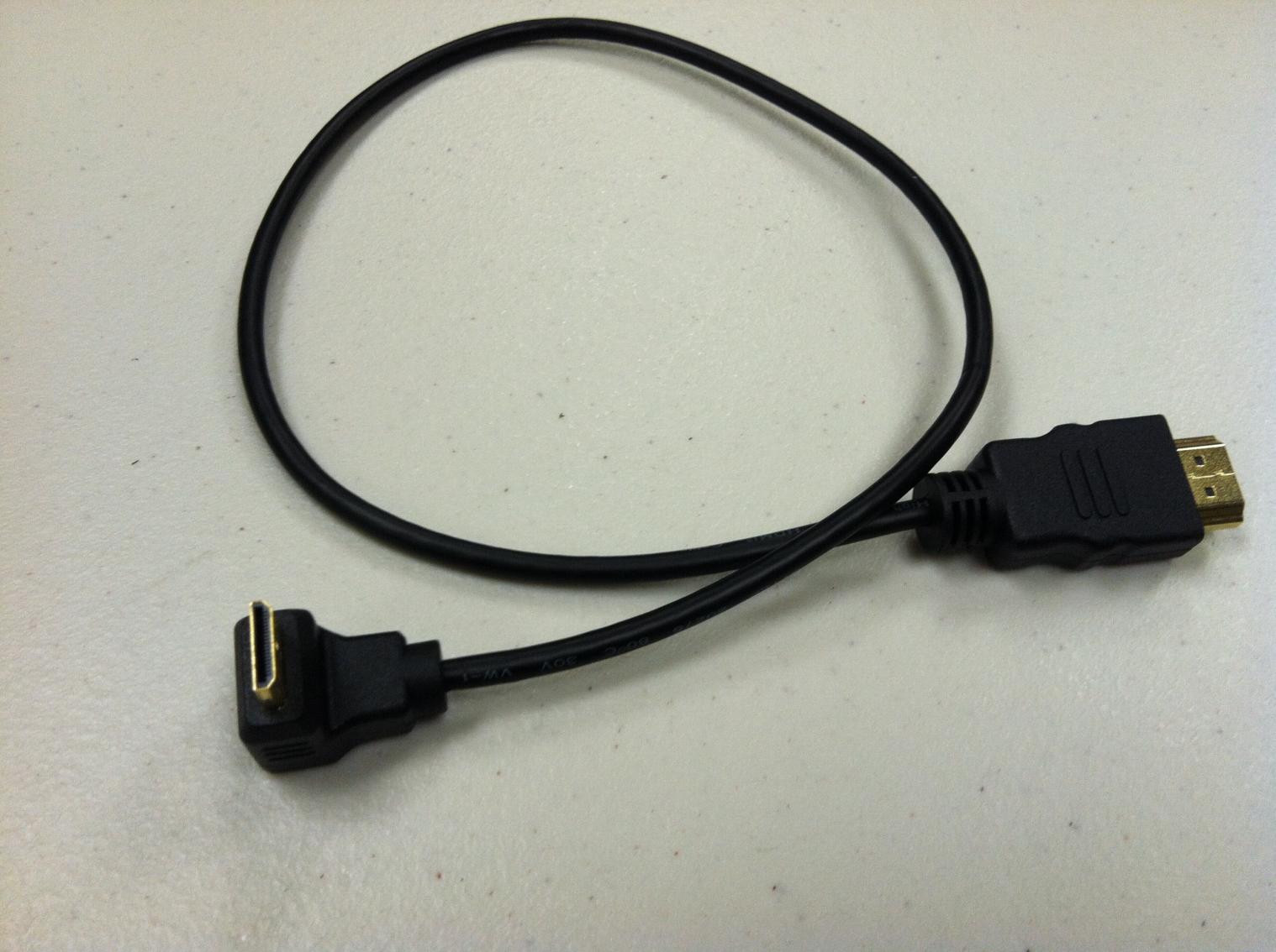

Hey guys, I will get these out into the wild soon. I had them made for camera mount applications where it is nice to have the right angle connector on the mini HDMI and pointed in the correct direction.

The problem with these cables is that the right-angle mini connector sometimes angles Down and sometimes angles Up. I know, I have three. Two Downs and one Up. What this means is that the angled bit will either route the cable down or route it up. Down is not always great because it can foul the camera plate - unless you have a judiciously placed slot - and Up is great for straight ahead shots but possibly awkward for straight down. The latter also places more strain on the camera's mini-HDMI socket because the cable does not benefit from the support of the judicious, movement restricting slot in the camera plate.
Tabb's rear exiting right-angle is a more sensible direction for the angle.
