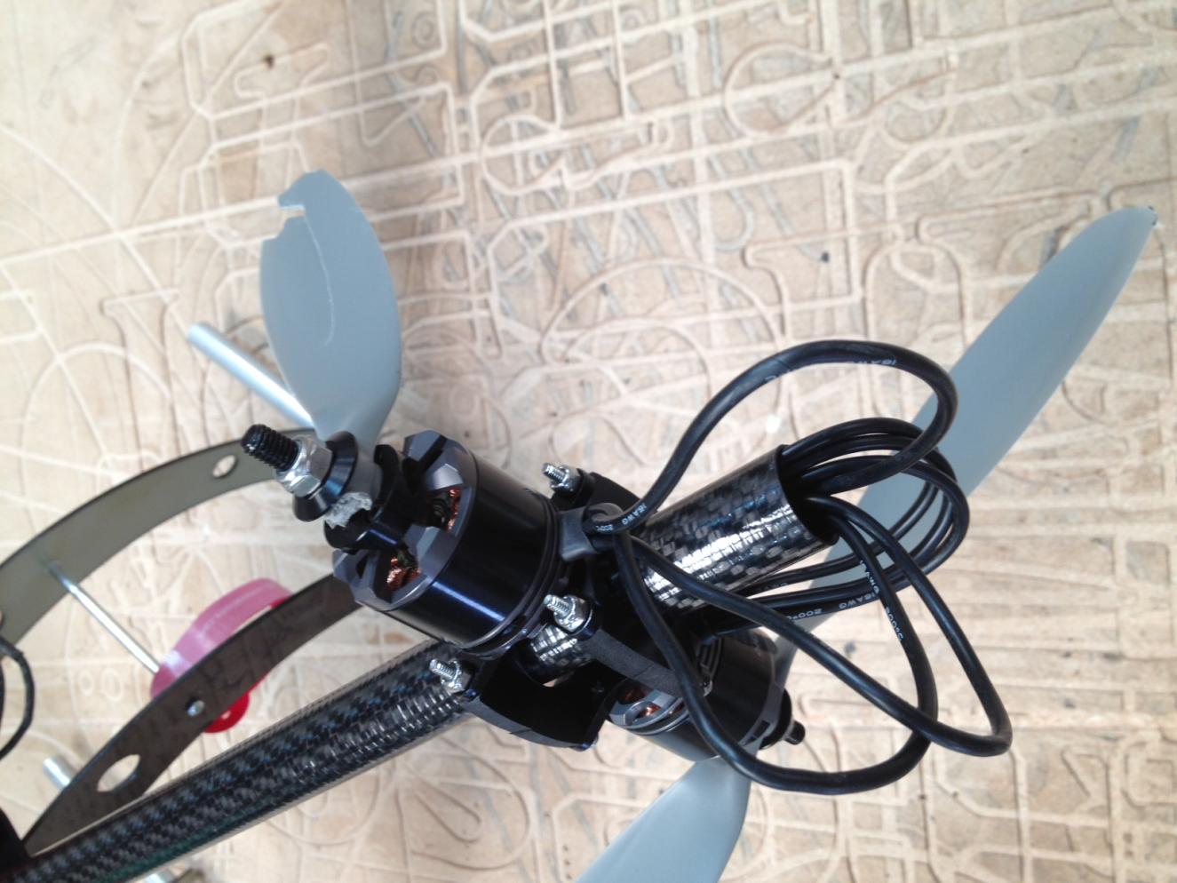

I have spent over a month getting this XY8 set up and making sure every end has been checked and checked again. I still feel absolutely confident that I have done nothing wrong construction wise or software wise. So today I found a moment of time to try out the hoverfly pro and give her some flight time. I checked all the parameters again on the software, I made sure all the props were rotating the right way, all connections secure. The alt sensor was covred. I flew inside my warehouse so there is no excuse for sun or wind being the cause. All lights look normal, all beeps sounded normal. First flight in manual mode, altitude double checked to be off. Flight was very stable. Hovered for about 20 seconds and landed it. I then flipped it into attitude mode and gave it another try. This time it was borderline uncontrollable. Had flight characteristics similar to DJI with gains way too high, very very wobbly. I was barely able to land it without damage. Next flight, I put it back in manual mode and increased the gains of attitude mode to +40 from +25. heres where things went bad and i dont think its from the gains but the heli started to hover somewhat normally, but then in the oddest way started to lose control but not elevate nor shut the motors off. I could not get the motors to turn off!!! I also could not get the heli to lift any further. So if it was an alt hold I think its possible but the fact I couldnt turn the motors off was very dangerous. I was not sure what to do at this point since I realized I either had to go through a whole set of batteries and let it die out or intentionally crash it as to make sure things didnt get worse. As I tried to hold a hover the heli seemed to lose more and more control. I had to intentionally drift it into a piece of machinery in the shop as to take her down. i didnt want to risk it flying up and doing massive damage to me or the shop or the heli. So now all props are completely broken or messed up, horrible sounds are coming from the thing and I am obviously wondering how the hell to turn this things off. the funny thing is that right before I took off I went and put on a pair of work gloves just in case something like this happened. I walked over to the heli as it seemed to be in a position that was more or less helpless. But when I went in to grab the battery cable it bit me in the arm and made 3 nice deep wounds.

Bummer man I had high hopes for that rig so I can't imagine how you feel. Sorry to see that and glad your injuries weren't worse. Sigh... Next eh?
DucktileMedia
I really just want to know why this happened. The ONLY thing that i can think of is that altitude hold was activated. but would that prevent the throttle from shutting the motors down or being able to climb? I was stuck at 3" off the ground with minor cyclic control. I'm willing to give this another try when my mental and physical wounds heal but if this was erratic behavior, then forget it. I might as well go MK. I'm just glad I decided to make a practice set of landing gear instead of using my new av200/360!

So I talked with Hoverfly this morning, amazingly helpful people. They told me that the Hoverfly Pro doesnt work in the northern hemisphere or when it is past sunrise. Kidding. I think the conclusion was that my alt hold got activated at startup, which prevented the heli from climbing and from shutting off. As i checked this before the flight on the software and the boxes were highlighted in relation to the proper switch position, I didnt think twice about it. but it MUST have been activated because the symptoms were exactly as they would be if AH is on at take off. My problem is that I am used to DJI's layout on my radio and the HF is completely different so I didnt have time to look at the radio and think about it. At the end of the day I learned a few lessons and Al at Hoverfly has made a great effort to get me back on track. They even offered to replace some components which they did not have to do. It will probably take a week to rebuild the heli and give her another try.
Hopefully others can learn from this that are going Hoverfly. Make sure your switches work and know them well before taking it up. also, have a backup plan. leather gloves, a towel and maybe a fire extinguisher! I dont know what happens to ESC's and betteries when you stop the props under full load and the build up that much heat. It cant be good for anything.
