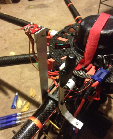

Resistors showed up today. Wires, Wires and more wires! But if it works, I will be happy. I see a potential issue with where i have it mounted. I might need to go further than the 12" servo extension. My main wiring harness is in the back of the center plate frame and up high (so I don't have a repeat of the panning camera unplugging my main battery!). The new compass is almost as close to where it was when it was on the main board. Maybe a couple inches higher. Maybe just being away from the rats nest in the center plate will help.
So, here is a photo. It might help the esthetic factor if I paint the aluminum black. Will it be o.k to have the Mag and the GPS receiver so close like this? Also, what can I cover the mag with to protect it? Shrink wrap?

update. I went out and tried to calibrate the compass. first attempt after I went through the process (it is hard to rotate an octo with av200!) I hooked up the laptop and checked the compass on the computer. It read about 27-30 degrees off. So I tried again. This time trying harder to keep everything in line while rotating. Same results. I used my iphone to compare the results and it read about 27 degrees off (front a bit too far east.) It was dark, so I did not try to fly and test PH. What now?

The external mag does not show up correctly in the setup client. (It says so in the release notes). Just make sure you calibrate it correctly and give it a try.
