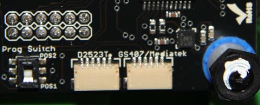

Hi Guys,
I am just starting to get my HFP + GPS installed on a FlameWheel Hex frame. I have a successful FlameWheel quad with Naza + GPS running but wanted something a little larger/smoother for AP work.
I have had a couple of trial "hops" with the hex but decided to wait for the GPS before getting too carried away.... GPS arrived yesterday :)
BUT (and I am sure I must have missed this somewhere) the GPS board differs from the manual in that it appears to have two connections for the MediaTek module not one (and it came with two cables). I assume I am being a dumb-*** but can someone tell me where to put my antenna?
Charles - sunny Canberra, Australia
DucktileMedia
Bluerex, I had the same question. The mediatek goes on the right port. It actually says mediatek on it if you look closely. Let us know how it performs once you get her up. Make sure to do ALL of the calibrations and test the compass as it says in the instructions. And double check all your switches operate all of the appropriate boxes in the software.
Bluerex
Thanks Stacky, it's HoverflyGPSUsersGuideV2 that shows only one connector... I'll do some more digging :frog:
