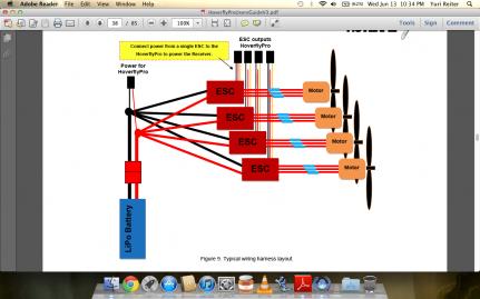

one thing i dont like as I assemble my hovefly pro is that they want you to use only 1 BEC input from the ESC's. So if that 1 bec fails from 1 of my 8 esc's the whole thing is going to crash.
Is it better to just use a separate BEC than rely on 1 of the ESC's built in BEC's?
the power input to the pro is from the power harness. i didn't see anywhere in the manuals where they wanted you to pull the reds from the ESC servo/control lines
DucktileMedia
Looking online it says specifically in to ONLY USE 1 BEC FROM YOUR ESC'S. I'll dig it up.
Denny, how does multiple grounds make any difference? lets speak logically here. If you add multiple BEC's with the same voltage, the voltage will be the same right? They are only drawing what they need so having more amps on tap wont hurt anything, right? And the grounds and positives are all on a common tap on the board. Maybe the voltage does multiply and i just dont see how.
Regardless, I dont like relying on a chinese esc to keep smooth power going to my brain.
Photronix
Pilot
Most ESCs should have an internal protection diode on the BEC so connecting them all to the PRO is not a problem. I personally never disconnect all but 1 power lead. However, some users in the past believed it might be a problem. So the manual suggests that all but one power lead be disconnected.
You can leave them connected and try it. Feel the ESCs and see if they are warm and watch to see if there are any problems in flight. I have thousands of flights with Turnigy and Castle Creations ESCs and I never remove the power/BEC connections.
DucktileMedia
Thanks. I am using 40amp Turnigy plush escs's. It would seem the bec's are in parallel and not in series so there shouldnt be too high a risk. I am a little confused though as there is a separate power terminal for the FC. Not sure why the board wouldnt just take power from the esc's.
From the horse's mouth. This really confuses me as they say anything over 6volts will fry the FC. but they show raw power fromt he battery powering the FC. WTF?
