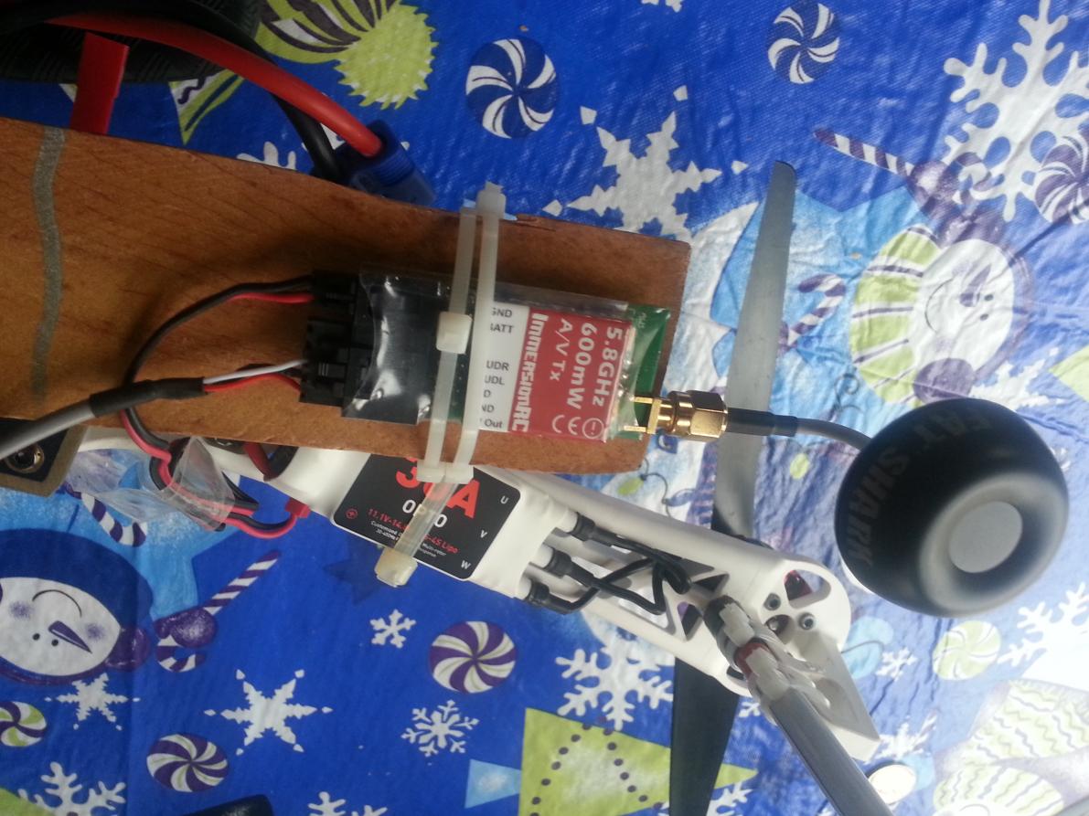

I currently have an Immersion RC 5.8 Ghz 600 mW transmitter and use it with a small FatShark camera.
1.) Would it be advantageous to get my FVP video signal from the GoPro? (I would expect the wider field of view would be better.)
2.) and if that is possible, what type of adapter or cable would I need?
3.) If the Hero 2 was wired as my FPV cam, would the field of view in my FatShark goggles change if I set different FOV setting the the GoPro?
View attachment 9825Thanks in advance for your advice.
