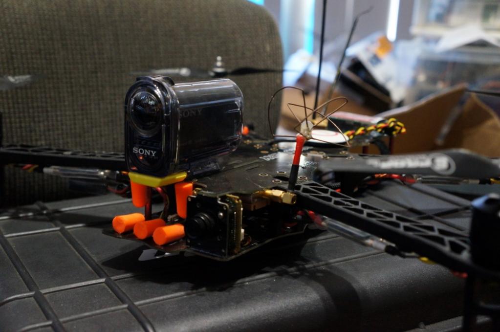

it is there, just not as good, this would do a hero, sony and has a pixim cam.....
one of the bigger things not using live feed does is eliminate the wire coming out the side or back. when you have that wire in, it transfers jello. without it is way easier to smooth out the video you get.
