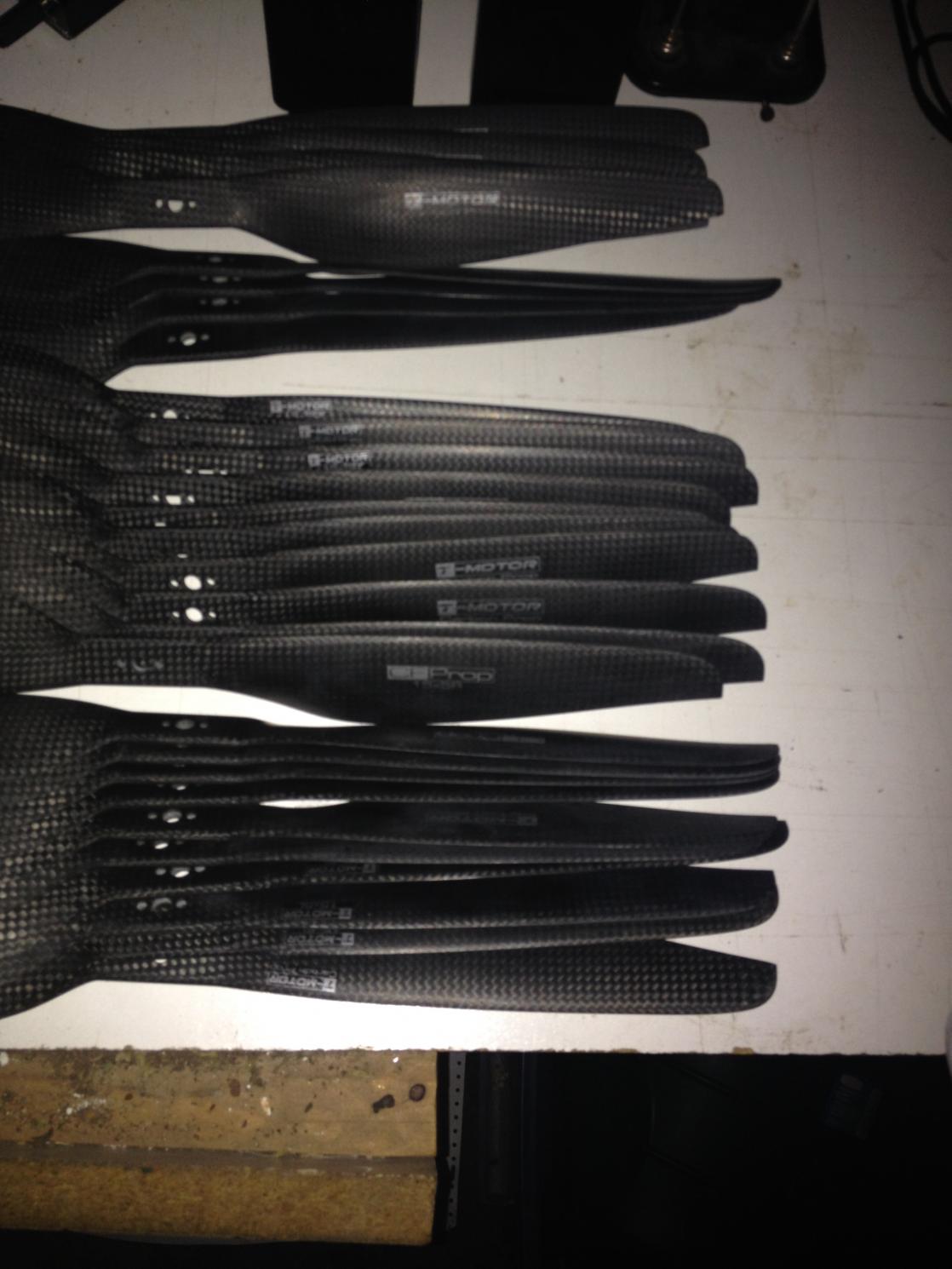

the newest kits are packaged different from what i remember and that rod is perfect. remember when i blamed the rod too cause didn't have a plan of attack, i just gave you THE way to do it. Try one, what is it $18...... I run 3 at a time, my pile of props looks like this
and that's just the 1100 and jibs pile..... try one, you can use a tape method instead, but it's not gonna be this exact
