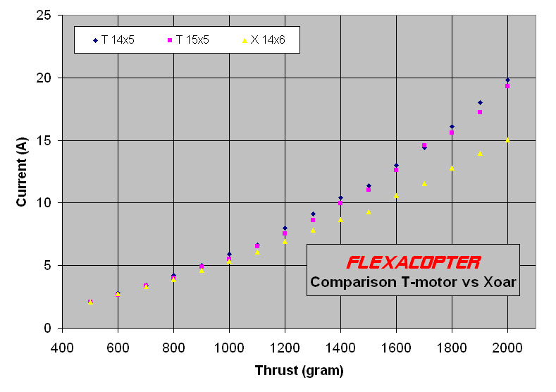

Like everybody know's by now (we hope) is that our motto is measuring is knowing ;) so we ordered two sets T-motor carbon propellers in the size 14x5 and 15x5.
The propellers are looking really good and the one's we received where spot on in balance and ready for direct mounting, although not extremely light they are much lighter than our reference Xoar wooden propellers :thumbsup:
Xoar 14x6 wood (after balancing) 26g
T-Motor carbon 14x5 16g
T-Motor carbon 15x5 19g
Because the T-Motor carbon propellers gave us a very good first impression Pieter already started to design a propeller adapter for the Plettenberg Orbit motors :)
One disadvantage and I think that's counts for all carbon propellers is that the carbon propellers akt like some kind of diapason, more than one time I was thinking that the bearings of our test motor where defective :eek: (I even ordered two sets replacement bearings LOL) luckily after a test-rig reference check with a wooden Xoar 14x6 propeller the motor sounded like new again :) the naturally damping of wood was clearly audible.
The test video's, (because of the improvised prop mounting no more than 2kg lift )
As reference the Xoar 14x6 prop
Not sure you can compare a 1450 prop to a 1460 prop; you will get more lift. Likewise 15" to 14".
im intrigued by the dampening effect of the wood though. Is there any evidence of reduced vibes reaching the controller? If so, I want a set ASAP!

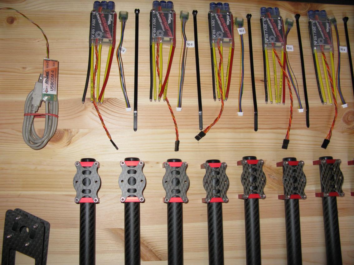

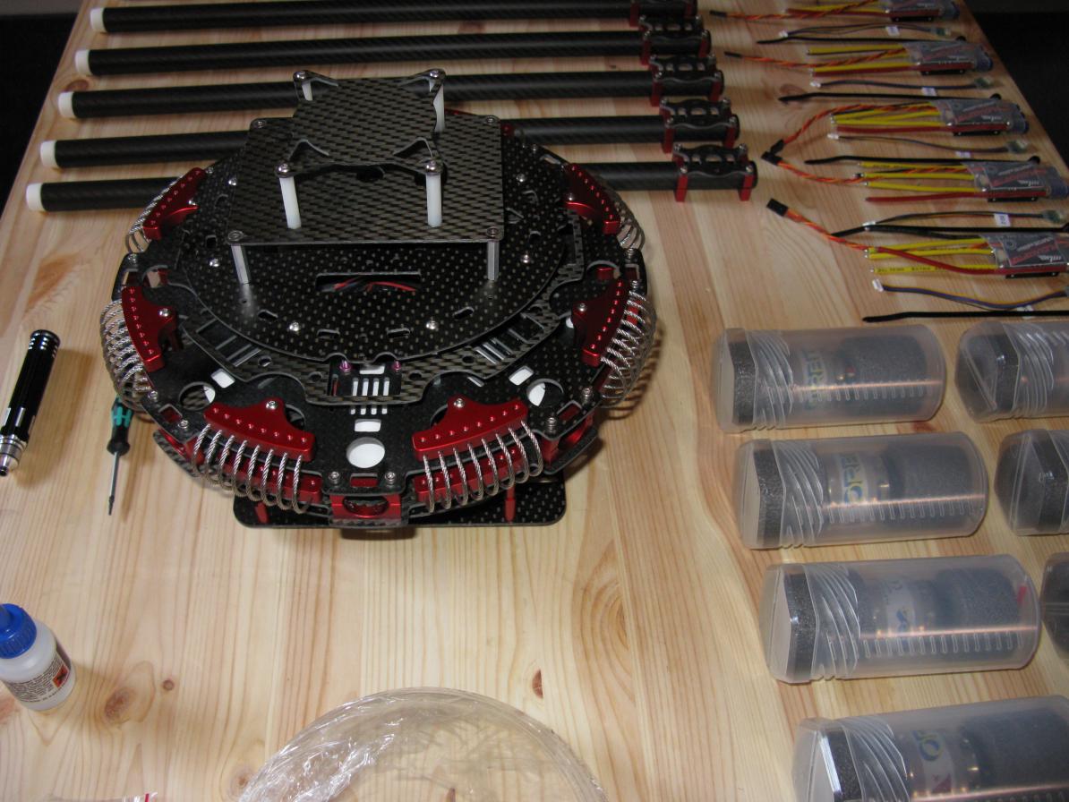

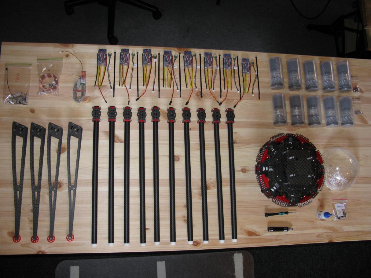

Yesterday, finally, was the day.. I picked up my Kratos..:nevreness:
I'm awaiting the coming of the DJI A2 before choosing my FC system.
And also the kind of BL Gimbal I end up choosing, depends on it.
Things seem to develop so fast these days, that I will finish "building" it before choosing either of those.
Also I'm still awaiting the soon to be delivered DJI retracts to have FlexaCopter find a way to attach it to the base plate.
Anyway, of course I wouldn't want to deprive you lurkers out there some nice "outta da box" pictures.. :cool:
