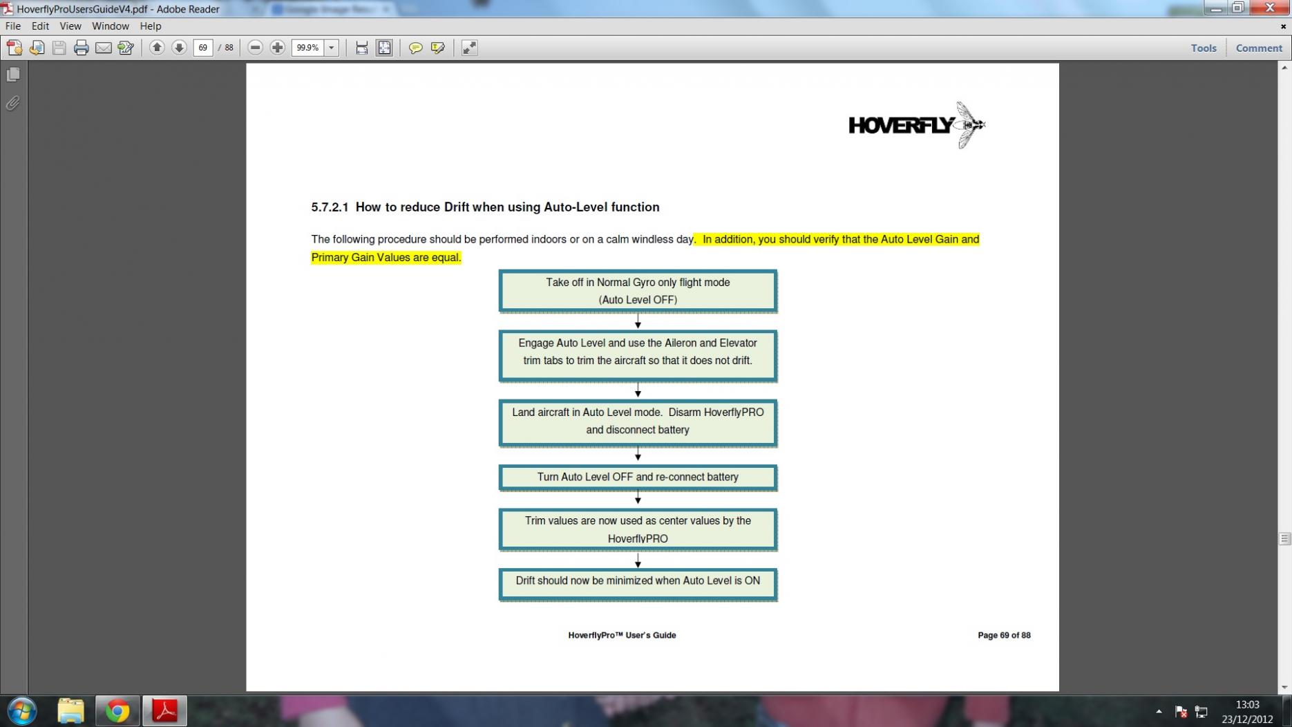

Hoverfly drift elimination proceedure
Bowley
When you do this proceedure: View attachment 8405 to reduce the drift of the craft. I assume that you can re-centre your trims before you connect the battery for the second time.
Any of you having issues with Altitude hold, mine goes up like a rocket, have not played around with the gain yet, still at + - 25.

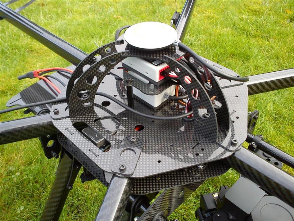

Alt hold working fine, HFP flying my X650 V8 splendidly in AL and a delight to fly in manual. and I'm well impressed with the HFP gimbal stab on the Xaircraft CM130TP Mount (a nice little gimbal as it turns out)..a good day, all in all.
