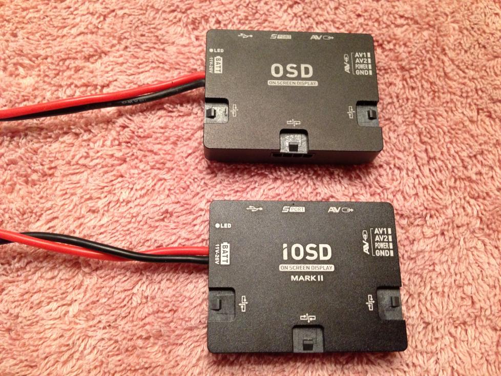

Tahoe Ed
MK II - What's under the Hood.

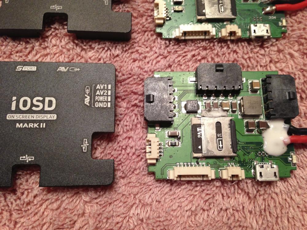

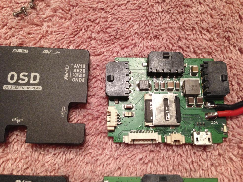

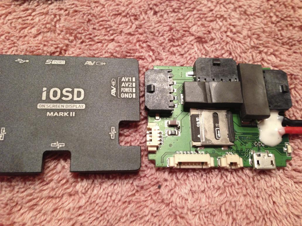

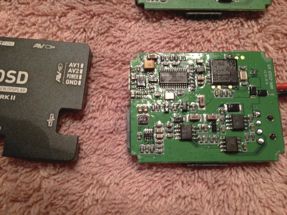

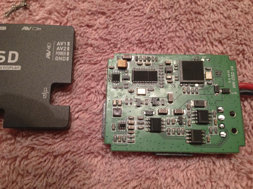

I just received a iOSD MK II and I thought that many of you would like to see inside the case and compare the MK I with the MK II.
The first picture shows the exteriors of the cases. The only difference is the MK II on the new model
The next picture is of the cases opened. The MK I is a v4 version of the board and the MK II is v5. There are some slight differences in the components, but since I am not an electronics engineer or designer I could not tell the reasons for the changes.

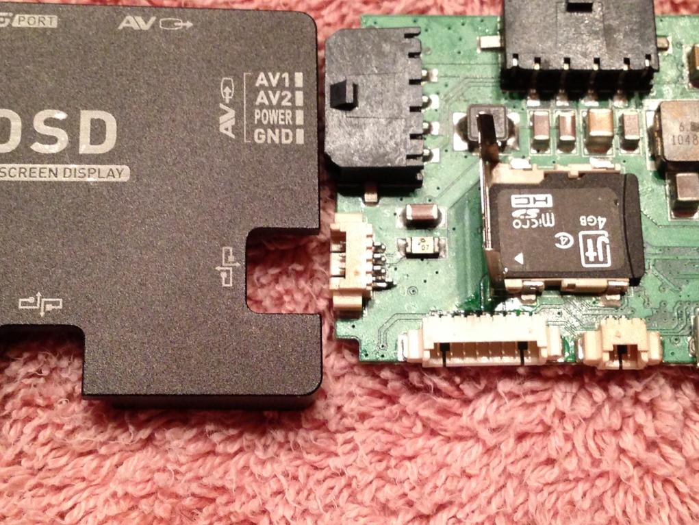

On the MK II you can see on the bottom of the board there is a conformal coating that is similar to what DJI used on the S800 escs. Also they have added a coating over the power leads and a blob on the side of the SD card. In the MK I this is absent and the SD card is easily accessible. Not so with the MK II. I was however, able to confirm that both the MK I and the MK II use the same 4GB SD cards.
DJI's assertion that either version will be able to be upgraded to the logging function seems, at least based on the hardware, feasible. I do not have any software to access the features of the iOSD so right now it is just another unit with the exception that the SOA card is no longer necessary. Probably the reason for some of the changes to the components.
As soon as I get the software, I will post some impressions. I also want to see if the MK I is easily upgradable
View attachment 8533View attachment 8534View attachment 8535View attachment 8536View attachment 8537View attachment 8538View attachment 8539

It`s not so easy to tell but looking at those pictures, I would say there shouldn`t be any reason why the MK1 cannot do the same as MK2? with a firmware upgrade
