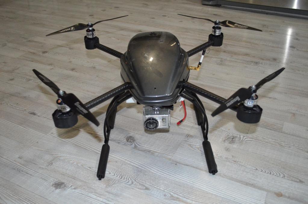

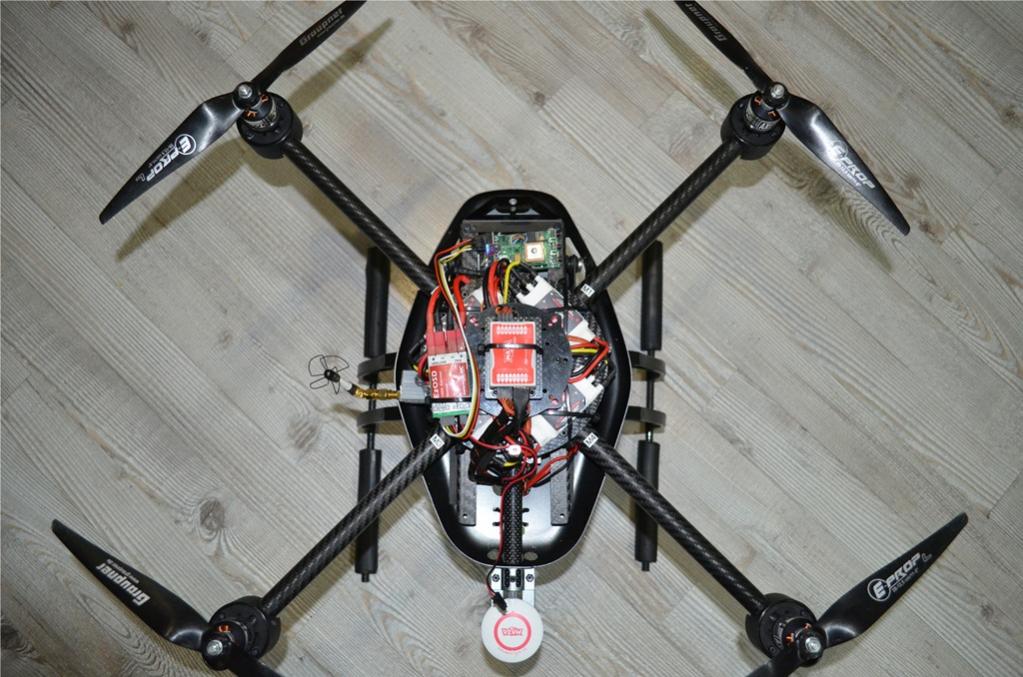

I had it weighing at 2.6kg on 10 inch props in the past and I found they got little warm. I've since switched to 11's and ditched the video tx battery and have it wired into the harness now so I'm lighter. Increased my flight times considerably. I'm not a crazy flyer by no means. Sorry for the non-droidworx landering gear. Wanted a quick pull-down system to reduce the size when carrying it on the kitbag. V2 of the CX has removable landing gear now that looks pretty good.

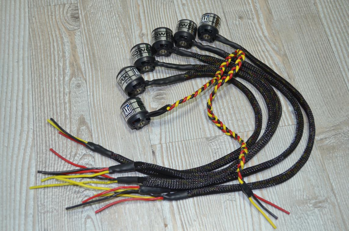

I purchased the motors and props from Electricwingman.com ... great to deal with. I think the Prop adapters come with the Droidworx 2217 motors from them now. Double-check, but the last motors I ordered did. I find the 11x5 Graupner eprops on those motors are a match in heaven. I used 10's but didn't get the performance I wanted.
I've attached a few pictures for you to size things up if you want. I've since braided the motor wires and lenght wise they fit pretty good. Another thing to remember is to keep the AUW (All Up Weight) close to 2.4kg or below on that CX4 frame. I've removed the landing gear and custom built the XAircraft ones for easier removal for putting in in my kitbag.

Nice braid work and sleeve! That should keep things tidy and safely away from the carbon fibre bits.

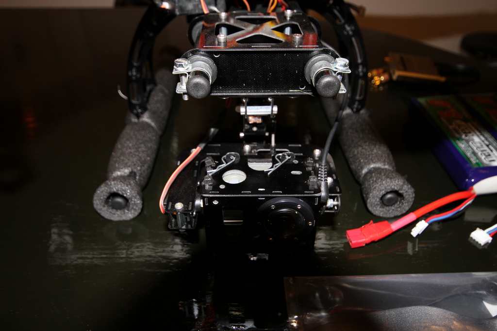

I also note that the PH Camera mount adapter (plate, lock pin, grommet, washer and R clip) cannot be found in the kit nor the box that the PH mount came in. I also cannot find them on any website for purchase. I posted a note to Linda at Droidworx but they are on Holiday so I don't expect a response until mid January.
The plan is to take a picture of the parts (bits and bobs) and each phase of the assembly. I now have a LHS about 2 miles from the house so it will make it easier to get the 'additional' things that I need (i.e. bulet connectors, loc-tite, wire wrap, etc).
I was in the same position with regards to the adapter plates. I had them sent direct from droidworx for about $15.
Thanks matthew.wright5. Ziggy commented that the extension plates are not needed for the CX-1. Istill need the pins, grommets and R-clips so I'm looking for someone that has a listing of all of droidworx component parts so I can order them.
Do you have a good source for spare / component parts?
The most cost effective option is to buy a set of the adapter plates. They come with the two plates, eight grommets, four pins, four r clips, eight washers. Best value! Get two if you plan on using the rear mounts too.
