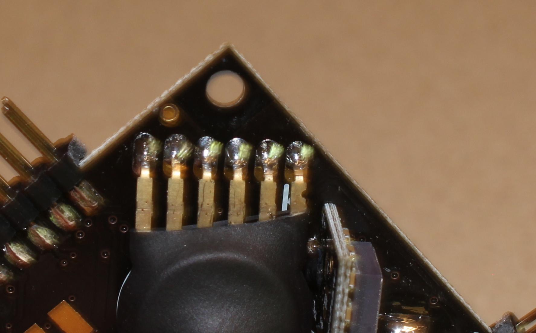

I just pulled my FC to see if anything obvious was wrong with the pressure sensor. Under magnification I was able to see that the right two legs are cracked. There is at least 1/8" of free space under the sensor so it's been vibrating away with every flight and the legs finally cracked. I would recommend everyone do an inspection and see if they have the same set-up (especially if they bought their boards ARF'd from Mikrokopter.us like I did). An easy fix would be to wedge the sensor up just a bit and shoot some hot glue under it, allow it to cool a smidge and let the sensor sit into the glue so it seats it.
Is it normal to have the sensor sitting up off the FC like that?

I put a ball of hot glue under the sensor and I think I'm going to overlay some copper wire over the two cracked legs and solder it in place to avoid having to replace the whole sensor. Any opinions on that?
Thanks,
Bart
I'd use something a bit stronger than copper, that can fracture easily from vibration as well. Go the local Radio Shack and pickup a cheap package of resistors, cut a piece of the wire off the end and use that, much stronger. The pressure sensor on my first MK F/C board has been mounted like yours is for over 800 minutes of flight time and its fine, you must have some serious vibration going on for it to crack like that or it was stressed from the beginning somehow.

I'm wondering too how it happened. Thanks for the tip on the resistor wire. I posted somewhere months ago that my altitude hold didn't quite work as advertised and that I couldn't climb from a hover in GPS PH. It's always been like that so I suspect the cracking started very early on.

The sensors aren't that expensive, the bigger challenge is getting the existing one desoldered and removed without ripping out a pad or trace. Since its junk anyway if I were going to replace it I'd just snip all the legs and carefully remove them one by one by heating and gently pulling it up out of the hole once the solder is molten. It can be done but it takes patience and the more soldering experience you have the better.

I had thought of that as well, cutting the legs then just heating them up and slipping them out one by one. I already took delivery of a new sensor from digikey for about $15 so that's ready to go. If the sensor still functions though, overlaying a piece of wire over the crack is the sensible thing to do, IMHO, rather than remove and replace. I can always do that over the winter. Thanks again for the help, it's appreciated.
